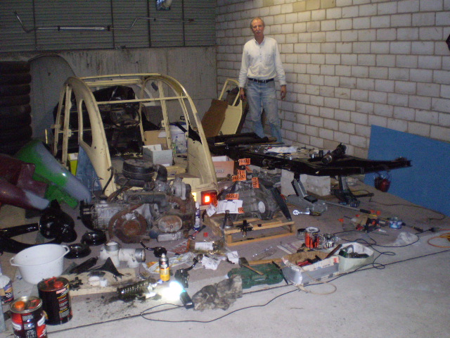

Not long before the start John invited me around to help with a few bits.
I love this photo. Credit to John for building his raid duck from the pile of parts.
Maybe John have some more photos
