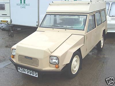

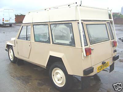

HI everyone, I know some you will know me from 2CVGB, but I thought I'd introduce myself anyway. I owned a few 2CVs many years ago but then joined the RAF and cars had to take a back seat (excuse the pun). 18 years later and I found myself looking around for a restoration project to keep me occupied through the winter as I have a well equipped motor club at my disposal and live away from home during the week.
I was looking for a car that needed some work instead of something that was already on the road and found Belinda on ebay. I'd always heard of Bedouins, but had never seen one and thought it'd be different so I went to have a look at her. When I did I managed to ignore what the vendor was telling me (very clean underneath, all the hard work done, just needs wiring) and see it as a body-off restoration and offered him a silly price if he'd deliver it. Having got the car here I assumed the worst when I got the car up on the ramp and wasn't disappointed so immediately decided to replace the chassis as it resembled a patchwork quilt. I wasn't too keen on the GS engine either as it seemed the previous owner had attempt all sorts of bodges in order to make it work (including some "Desperate Dan" bracing to the chassis and some butchering of the bulkhead) so I decided rightly or wrongly to fit a 602 unit. I know that other Bedouins had twinpot units, but mine is slightly heavier, so I might find that performance is more like a 2cv4.
So where am I at the moment? Well the chassis has been replaced and body put back on. I'm currently in the middle of repairing the floors and bulkhead, having already replaced the outer & inner lower bulkheads and welded up some of the butchering carried out during the GS engine installation.
Since buying Belinda, I 've found out that there were probably only around 35-40 ever made and 2 of those were campers, of which Belinda is one so I'm convinced that saving her was worth it.
