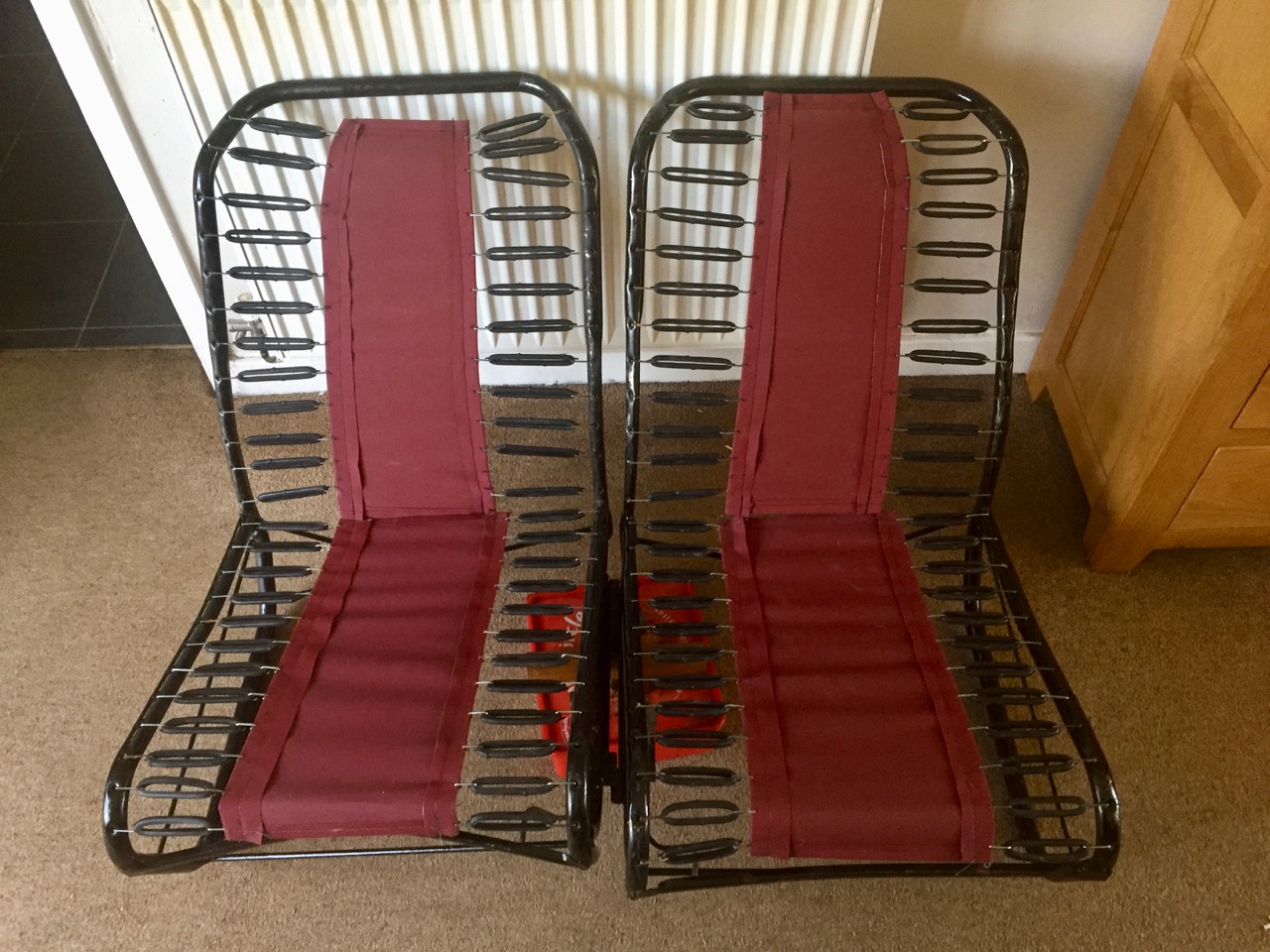

Job 1 - Seats.
Matts Soft tops supplied a truly excellent set of covers and bits etc.
Frames painted, base and back fitted.

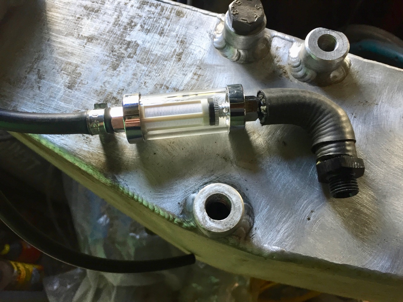

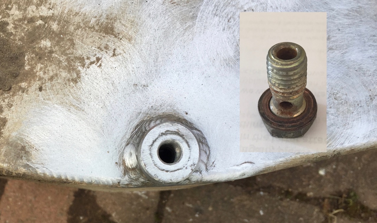

Fuel Tank Woes.
Have had "problems" with blocked outlet on my fuel tank.
Drilled out and tapped to 14mm with a gradual bend and glass tube filter.
Before outlet.
New Outlet with filter.

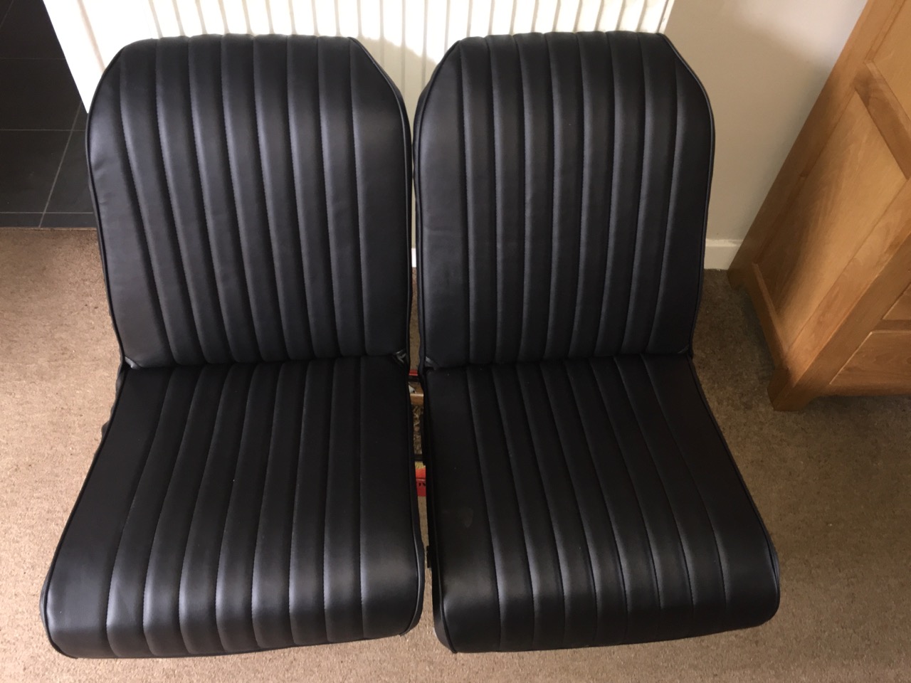

Fitted the new Vinyl seat covers, Very pleased with the result.

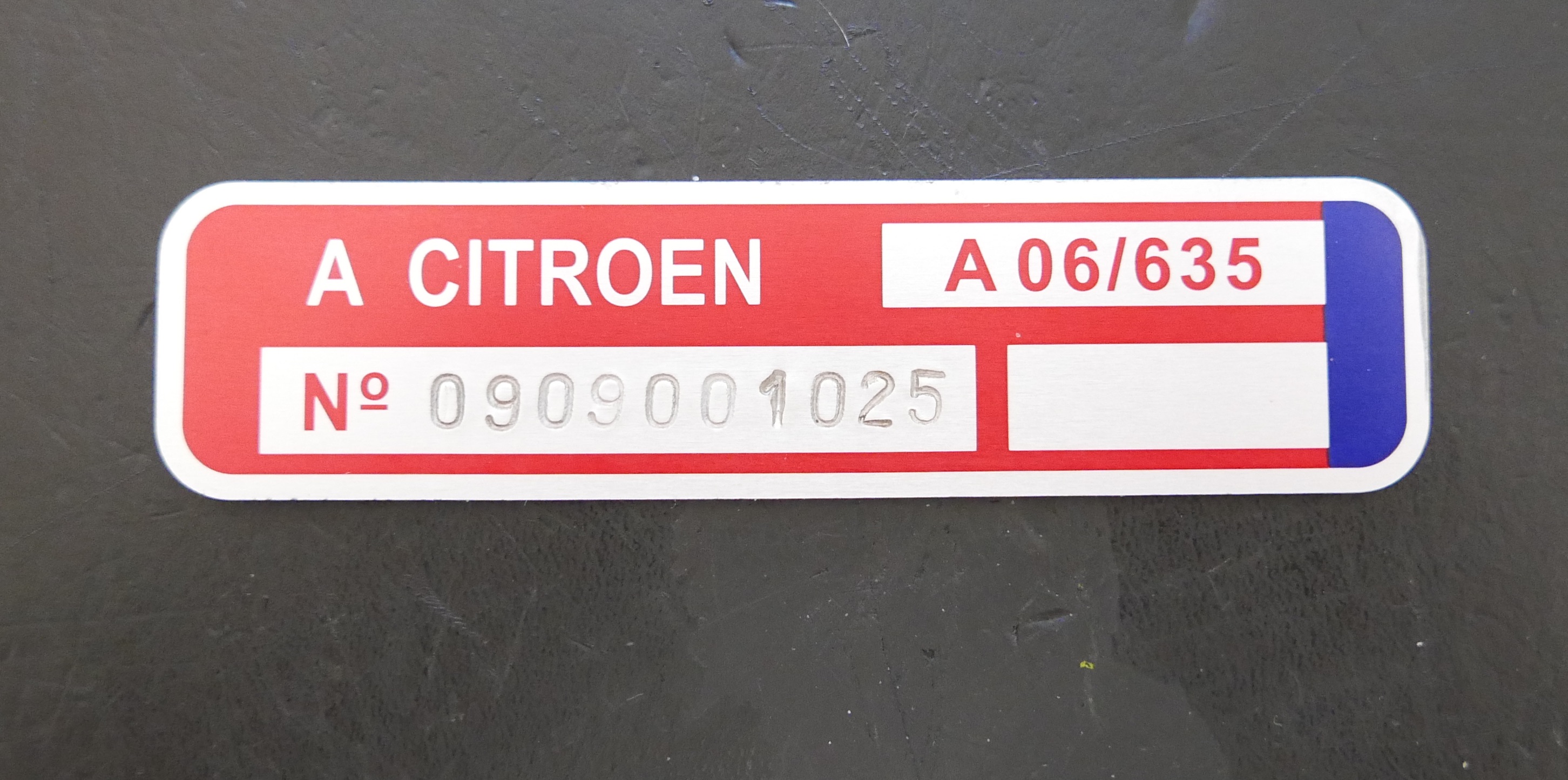

Engine Plate now matches what is stated on the V5.
