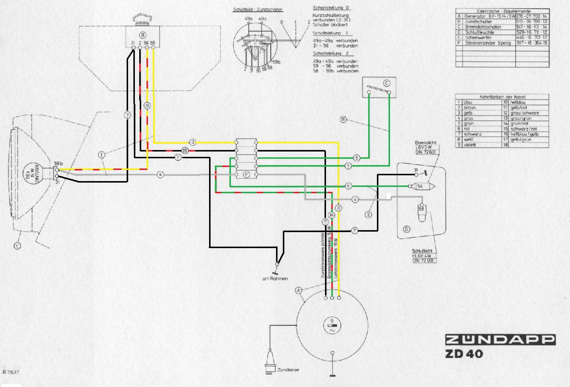

Quick update - put the top end back together and had another go at starting it up - IT LIVES!!! But not very well. Idles okay when cold but dies after a couple of minutes. Won't really run at all without the choke and cuts out on anything past about half throttle. I think this indicates running too lean? My carb strip-down was pretty basic so I'll try giving it a full disassemble and clean and see how it goes. The seal that the float bowl seats to looked pretty ugly so maybe sucking air.
Nice idea on using the tumble drier, DD. I'll give that a try soon, although not sure how the other half will react. I was amazed when I asked how she'd feel about me bringing it into the living room to work on as it was pissing down outside - instead of the earfull I expected, I just got "Do you need a hand bringing it in?" :o
It seems to me like its had some rewiring over time from comparing what is there to an old wiring diagram I found online, my assumption being that it needed some changes for a UK MOT - wiring diagram only shows single-filament bulb and no horn, unlike mine.
