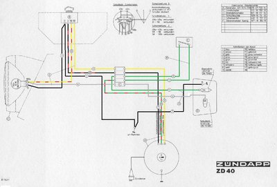

It seems to me like its had some rewiring over time from comparing what is there to an old wiring diagram I found online, my assumption being that it needed some changes for a UK MOT - wiring diagram only shows single-filament bulb and no horn, unlike mine.

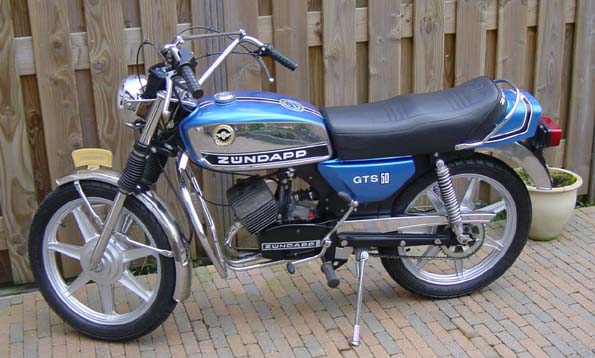

Didn't see those often overhere. Here we had more this model...
