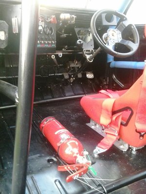

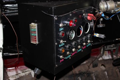

some pictures of my build! I will put more on as I upload them to my laptop!

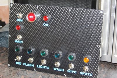

Colour coordinated axle and stands :lol:

I like the idea that you can switch the rain on or off too. :)

i wish turning the rain off was so easy!

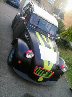

That's looking like a tidy car.

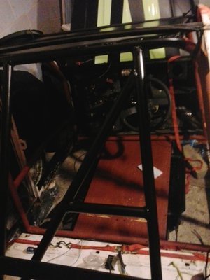

October 4th, 2014, 8:57 pm

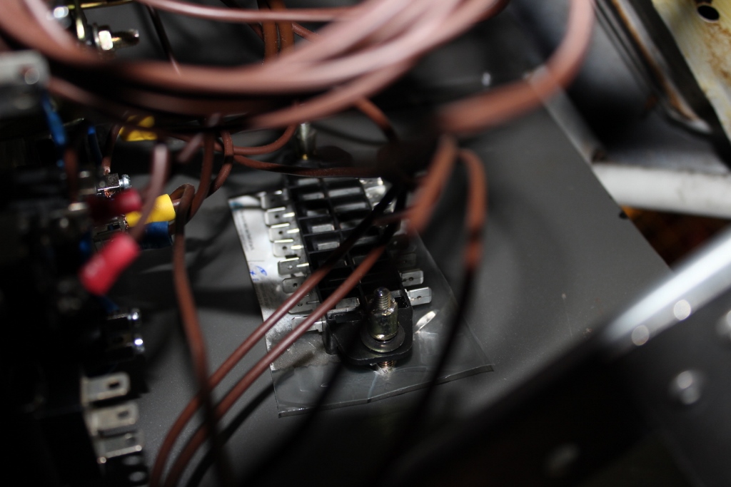

Post Re: Stella - my tin racing snail!
excellent !
just a few small details - get some copex or protection on the cablng - the tape will get oil soaked and let go.
if its a solex carb you need to have 2 return springs as per the MSA blue book, the weber has a return on the spindle so you only need 1 to the fan shroud
"p"clip one of the brake line coils to the bulkhead that brake line will be shaking all over the place
re think the position of the transponder LOL ;)
see you next year?
Sean
October 4th, 2014, 9:08 pm
Joined: December 28th, 2013, 2:05 pm
Posts: 60
thanks for tip about spring! its the + terminal of the battery not the transponder lol and will get straight onto the p clip tomorrow!! and I hope to see everyone next year.......lapping me in my economy car lol test day is this Tuesday at oulton!
