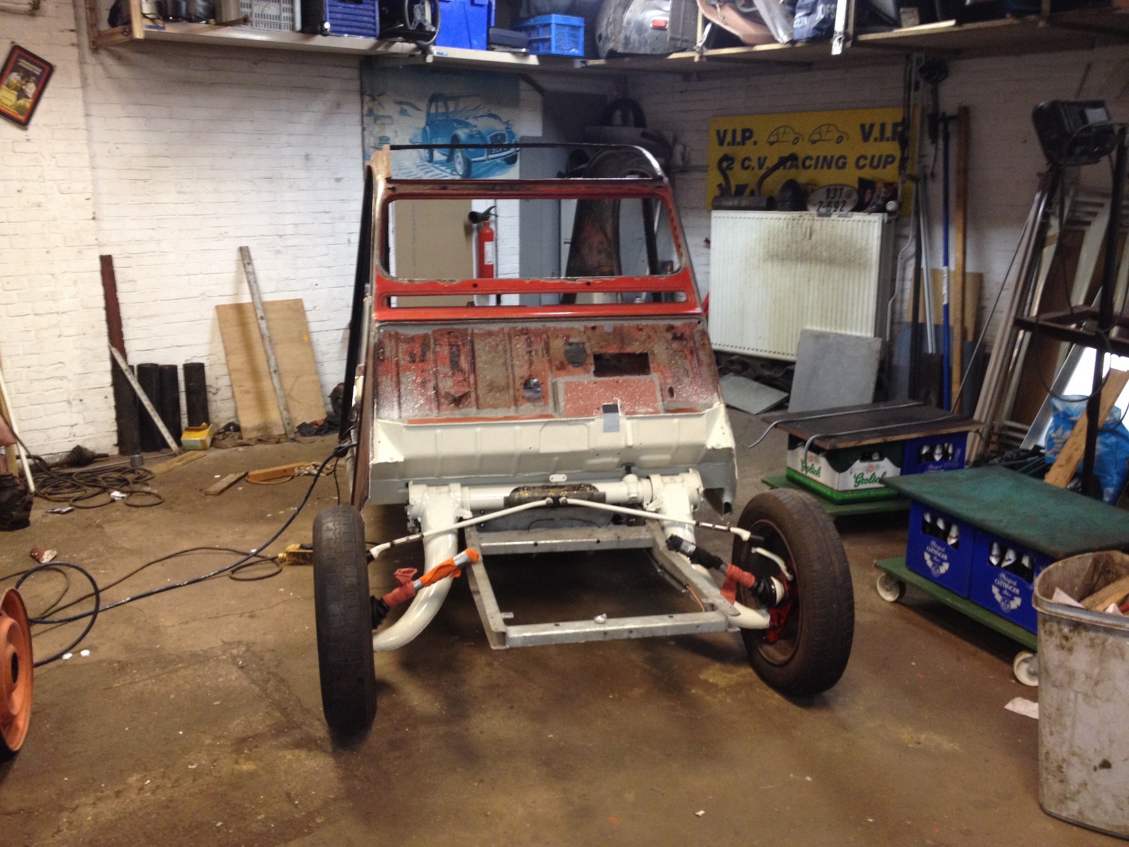

I did a lot of reading here but will now try to share some of my own fiddlings.
Still trying to build my 2CV, should be ready before the summer. Since it already feels like summer it's time to hurry.
The base was a butchered and rotten Citroën AZS from 1961. Complete underside and about 10" up had to be replaced, rear inner wings, window surround including cross beam under ventilation flap and the hinge.
Chassis is one from 2CV shitty, and indeed it is a shitty chassis, parts are welded out of line and the whole chassis was twisted. This last bit we corrected with 2 heavy guys and some long poles ;) Front axle is from Acadyane, rear from Ami.
Suspension is from Airbagit/A.I.M. industries/Chassis Tech, which is another supplier you wouldn't want to do business with. (complete untrustworthy bastards)
Engine will be Acadyane or Visa for now, but since i'm dreaming about BMW power for about 15 years, i'll keep dreaming about it some more ;)
I made a lot of pictures but because of a lack of organisation, not all at hand at the moment (and i'm to lazy to resize and/or upload).

You can't get away with showing us only one photo! Come on, lets see some more of it!
Are you saying that you like seeing photographs of poorly designed and inadequately welded chassis?
Fair enough, here's a few for starters... ;)

No I wasn't, I've patched up several City chassis before and I'm about to bin the terrible Frome chassis off my car which is slightly better than City and marginally worse than the GW one I had to suffer on my bamboo. I'm fully aware and experienced in crap chassis. But thanks anyway.
I meant I wanted to see more of the rest of the car...
March 12th, 2014, 1:14 am
Post Re: AZS modified
Sorry, only had 2 photographs of that car sent to me.
The other one showed the n/s/f corner of a blue 2CV heading groundwards, a sort of one-sided version of a rusty chassis collapse.
