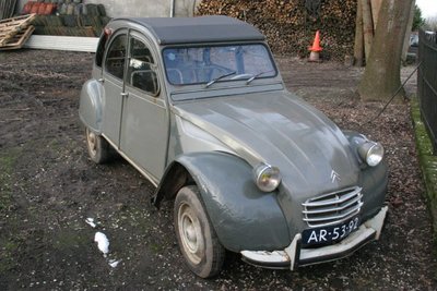

Some months ago, I spotted a 1965 2CV AZ on the internet. It was advertised by a NL dealer in the middle of our country.
As I pointed it out to my brother, it seemed that he was interested too, so we both went to see the AZ . In the end we bought the car and now I am co-owner of a AZ plus a spare engine !
We want to restore it and make it roadworthy.
The colour is AC 118 ME , Gris Etna, where as the ME stands for Merville, the producer of the paint.
The engine is original, but someone took it out and put it in again without any care at all.
The engine is not stuck, but we will have to split it , because one of the cylinders is not getting any oil , so the seller told us. The extra engine is for spares for the original engine . Any way it is a new adventure and as my brother is a keen 2CV enthousiast himselve we will have a mutual hobby as to turn the ugly duck into a beautiful swan.
Some pics.
For some reason I can't get more pictures in my post .
But here it is !
