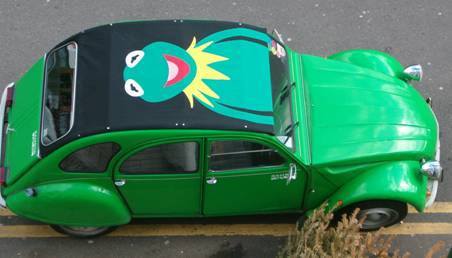

Well, given that I populate this forum with random threads, questions, answers and abuse I though I had better share what it's all about.
Having had it off the road for 4 yrs for a full custom resto :twisted: I got f@*%ed in the ass by an Egyptian just 6 months later on NY's eve :twisted:
After threatening him with my pregnant wife :lol: his insurance payed me out at market value, less the cost I could get from a wrecker should I want too, so I came out with $AU9800, win.
My brother is currently tin bashing it back into shape.
He used the olds 4x4 winch and a BFT (big fuckoff tree) to pull it out :lol:
removed the custom tail light panel in a hope to preserve it...
Realised that a lot of the welds had cracked and the edges where squashed so now it will have a new ass! :D
Getting there...
Kermit has been in the family since 1993ish, English import, it was the car I drove to pass my drivers licence and I have had it ever since...
Kermit started it's life as a '74 square headlight drummer...
Now it has a Channelled body, Suicide doors, Custom tailight panel, Removed 3rd window, Greasable font wheel bearings, Reinforced chassis, Chopped reclining GS seats, Uprated springs, Rose joint tie rod ends, LNA gearbox w/ GS disc brakes and calipers, Megasquirt multi point fuel injection
I have modified Visa 652cc which should be complete very soon!
Twin spark, Forged pistons, Larger inlet and exhaust valves, Custom cam, Anti surge oil pan, AMR 300 supercharger, 1-2-spark :D
