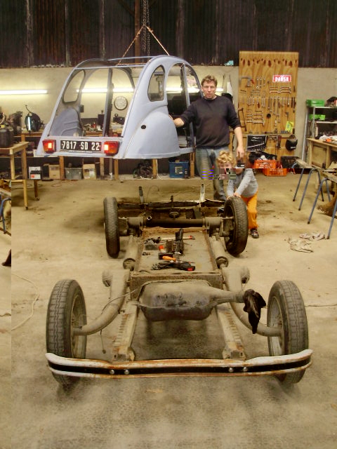

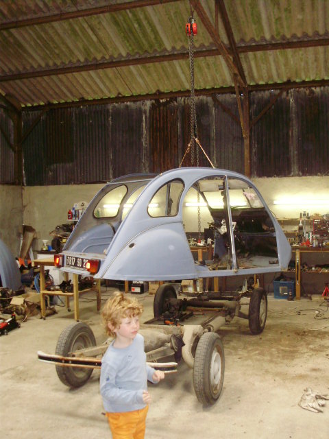

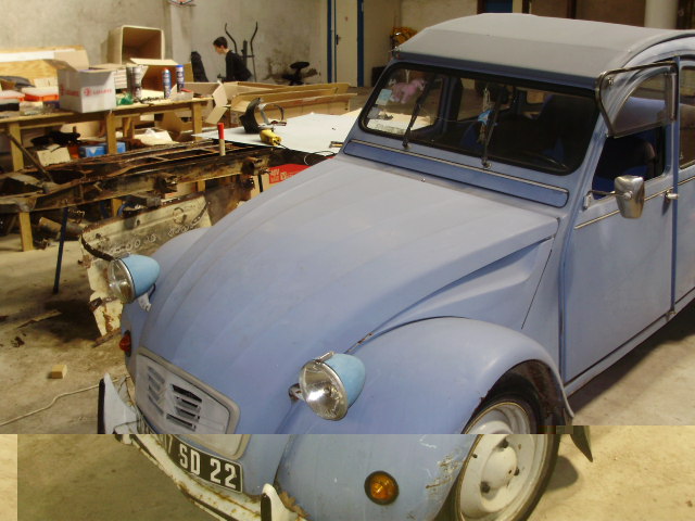

Just bought this little beauty. Chassis collapsed and put aside to rust away by previous owner.
Not sure what to do yet, have a few options.
Chassis change only and fix some of the rust.
Partly restore it to average
Give it the full monty incl paint
Prepare it for Raid Africa.
First thing to do is to get a galvanized chassis to rolling stage. Then decision time for the body.

Eirik the red, Viking junior is a great little helper.

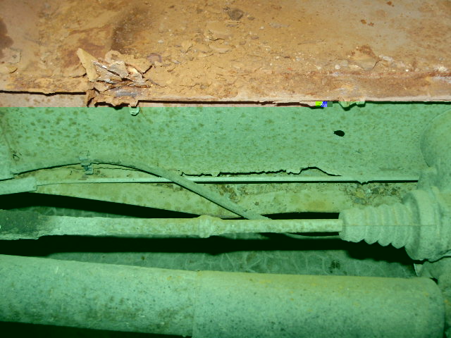

Rust never sleep

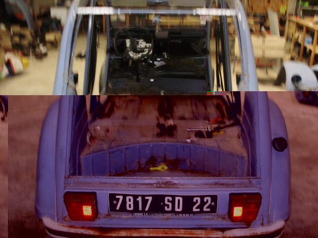

the body looks remarkably sound in the pictures...
April 25th, 2009, 3:32 pm
Post Re: 2CV restoration job

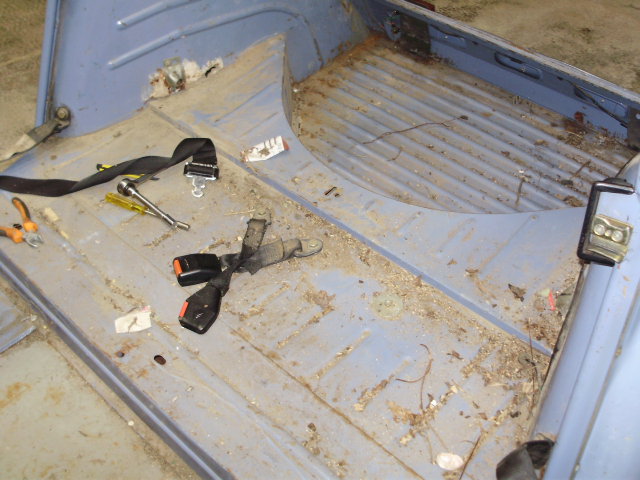

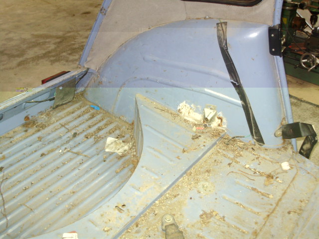

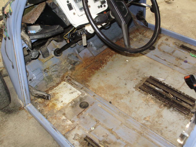

Not too bad. If I decide to restore it completely, new pedal floor, 2 new floors, 2 sills, 2 inner rear mudguards, boot floor and number plate panels will be replaced. All 4 doors are ok, same for bonnet but boot lid is damaged. Windscreen panel/ bonnet hinge needs very little work.
Last 4 new wings + all the lose bits. Big job, maybe 600 hours incl all the mechanics.

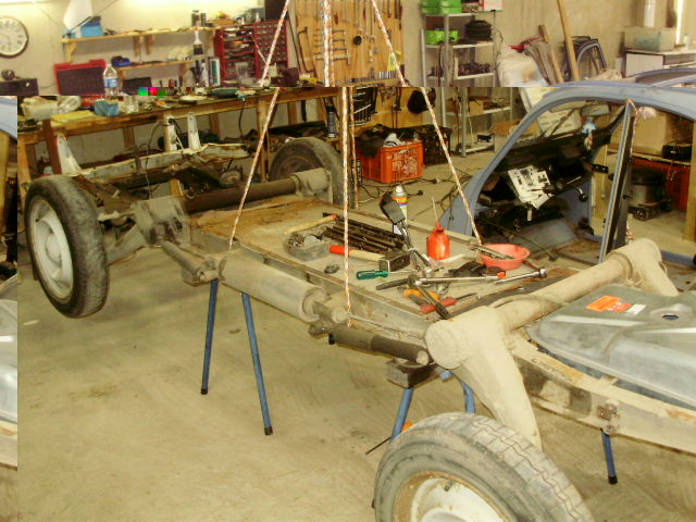

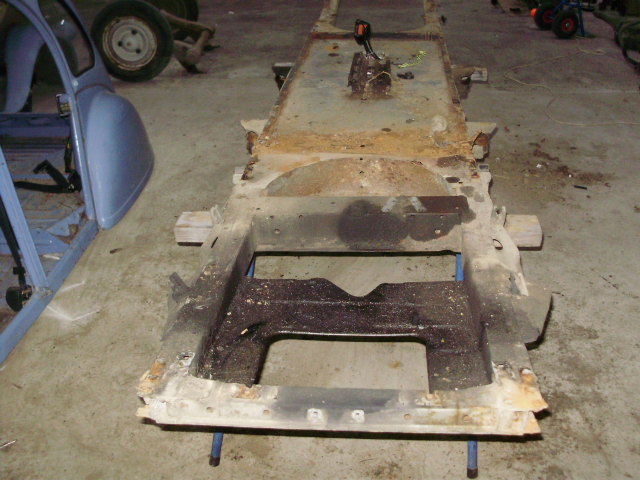

Time to strip the chassis.
Done, not too many rusted nuts and bolts on this one, only me :mrgreen:

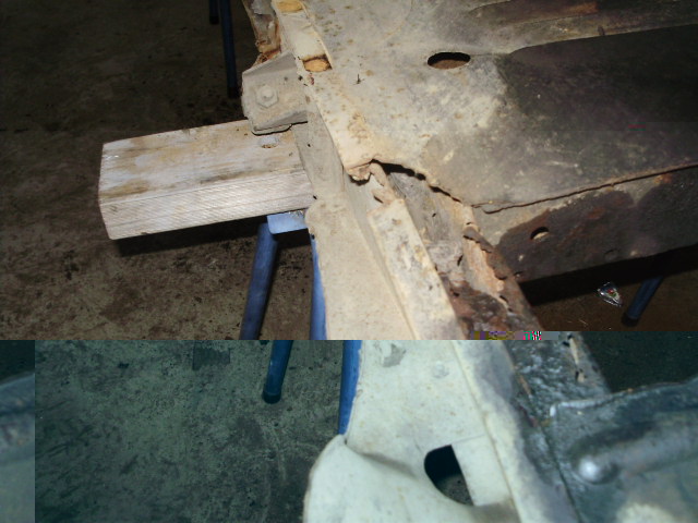

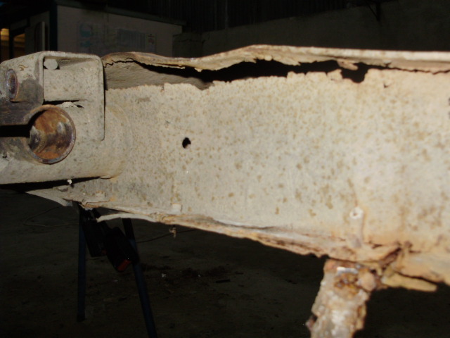

Nasty tin worm attack, goodby chassis.
Original chassis from 1986. Rust never sleep
