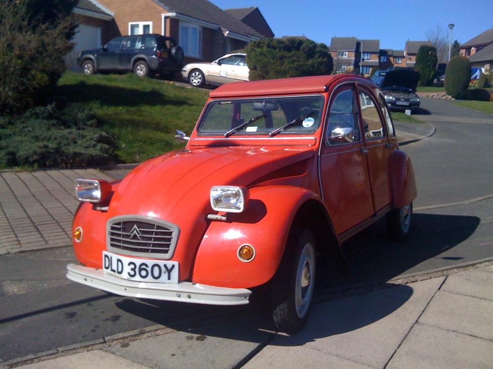

Nice looking car!
I think the previous owner is on here, 'Deano'.

Quite possible as the guy I brought it from races historic Astons from time to time, it also has an Aston Martin owners club sticker in front screen.
