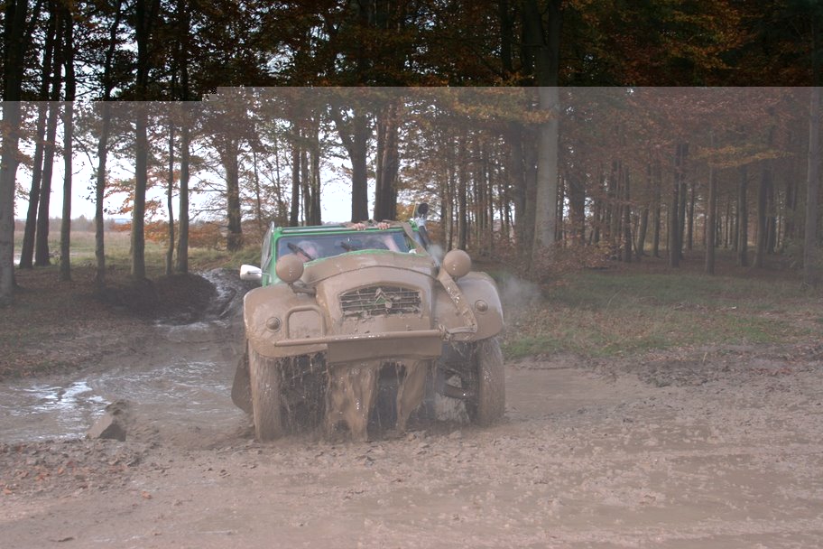

File comment: this is how we bent our chassis

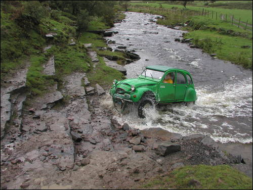

File comment: in water
