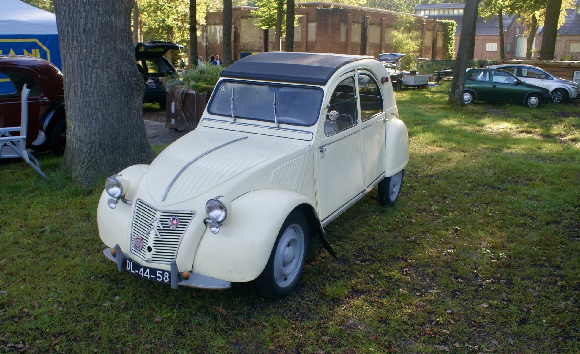

Well a bit sad news, i am going to sell the ivory 57. It was my winter car to drive to work. But as i don't have the job no more and i have an C3 for winter driving. The car is become obsolete. As the green 57 is sitteng in the garage for 1,5 year now without being moved...so i had to make the desicion to let it go. :cry:
April 13th, 2026, 6:21 pm
