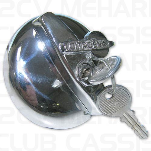

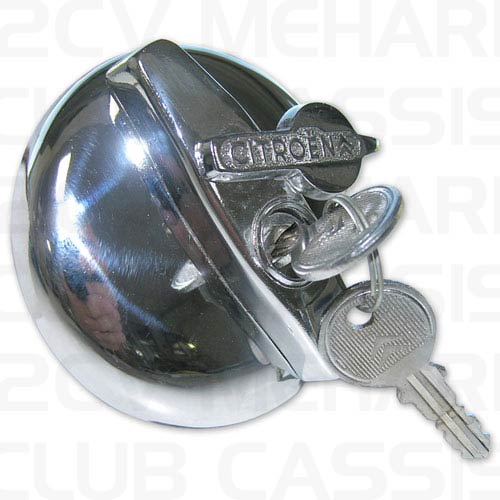

My lockable fuel cap like that on the picture came apart in my hands. The rivets that hold the lock ring to the cover gave way. I tried to rerivet them but it didn't hold. So i drilled in the rivets and tapped M3 in there. I screwed it back together with some locktite. Hope it hold now.

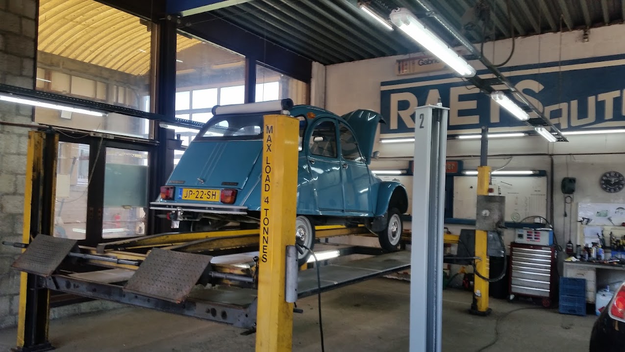

Passed at the MOT today. All clear i may drive for 2 years again. Nice picture with hanging wheels.

Thanks. It had a little play on the king pivots. Horizontally ??? Never seen that, normally it's vertically. The lower hole seems to be a bit oval front to rear...

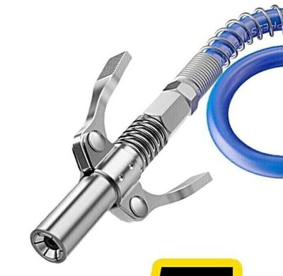

Bought this mouthpiece for my grease gun. It clicks on and there is no leaking grease at the nipple. Works well. only the blue tube is a bit stiff. I used my old one in rubber.

https://www.ebay.de/itm/134977048851
this is only one you have to check out the lowest price. I payed 8,50. There are dozens of offers.

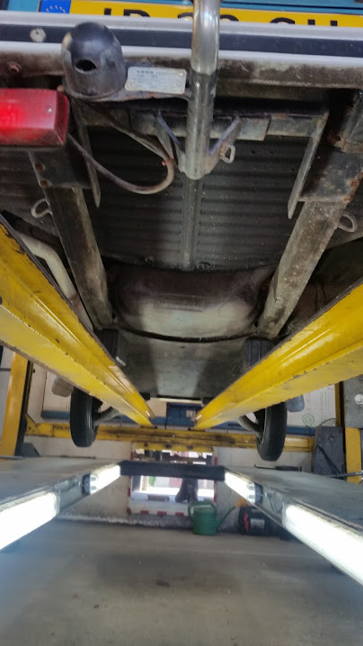

If it might interest someone an other picture off the 2cvs underside at the MOT. Nice dangling wheels.
