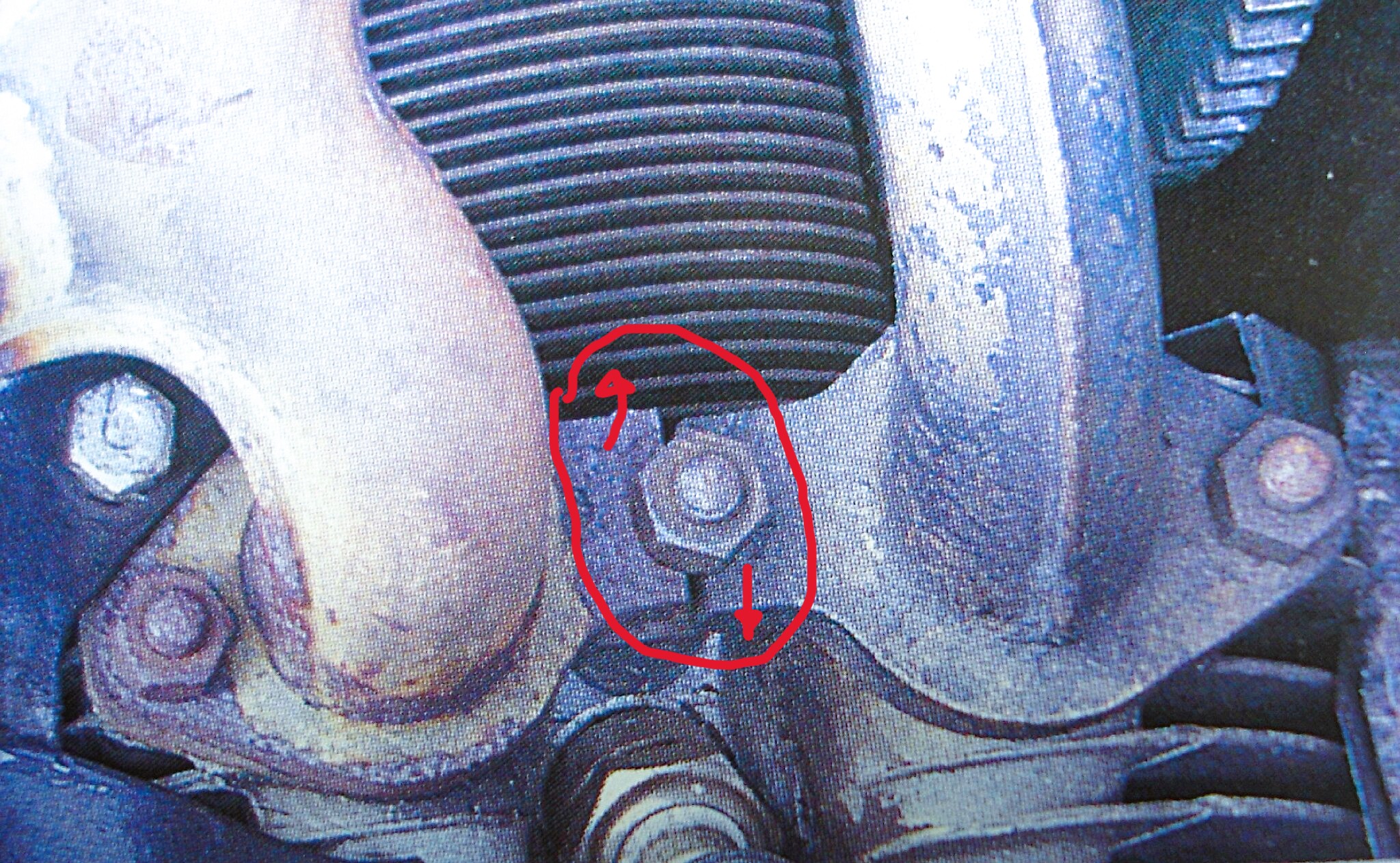

Post Re: AZL 1957
Teh oil smell is gone but there is still some exhaust fumes coming. In look ing closly yesterday i did see some cracks in the manifold gaskets. So i wresteld the manifold off the engine and yes a lot of soot left and right of the exhaust ports of the cylinderhead. So cleaned all up put new gaskets in. Car is a lot quieter now and i think it worked. Will check during a drive soon.
January 29th, 2025, 4:34 pm

Post Re: AZL 1957
Yes that can be. I did feel a little blow at the left side and did feel i could torque it a little more and the leaking stopped. The manifold was a bit bent the middle hole didn't fit nicely. I had to force it off and on the engine. See the picture of a similar distorted one. Mine was even shifted more.
January 29th, 2025, 10:36 pm
