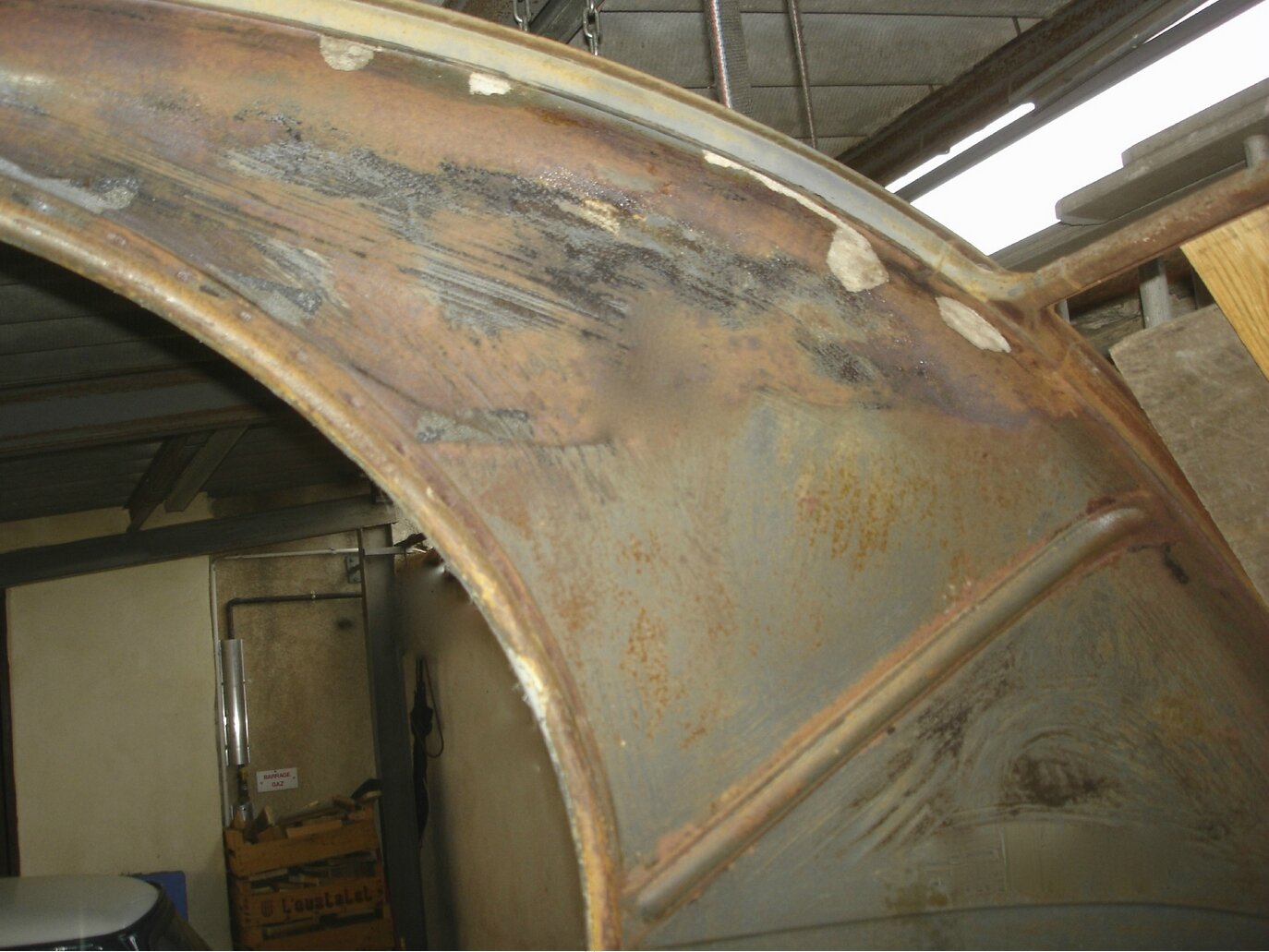

It seems, that there should be a reinforcement where the third side window should be in later models . As we have removed the third window, we are wondering if there was a reinforcement in the past, and how it would look like and where it was located in cm.
Any one an idea ?

Hi Geert is this what you are looking for?
June 5th, 2024, 9:34 am
Posts: 1186
Post Re: �1965 2CV AZ
yes, that is what i was looking for ! Nagyon kösönöm thank you very much
Do you have any measurements?
June 5th, 2024, 8:17 pm
Posts: 1186
It is a bit difficult to make with that bent, but my son will figure it out.
June 5th, 2024, 8:25 pm
Posts: 2253
Make the profile flat and then cut slots in it to bend?
4 cm till the wing so not till the profile in the bodyside. Mesured from, the reinforement's edge.
Foto even uitvergroten.
