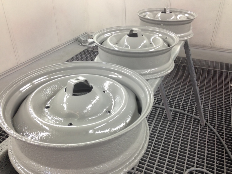

Question I have just had my 5 wheels painted after I had them sandblasted. The sandblasting revealed small indentations caused by rust over the years (pitting). The wheels were painted with anti rust, primer and the final coat. I was expecting them to be smooth like new specially as I am paying €350 for the 5 wheels which is expensive in my book. Am I expecting too much here Also, I think the colour is wrong (I have not seen them in the flesh yet). I asked for AC126 Gris Perle and this is definitely not that - again what do you think. Attachment:

i don't know about the colour, but there is a primer I used for some battered pieces of my van , which fills in the rust-pittings . Sort of filler and primer in one.

It is ColorMatic 1K filler/primer, it is the professional line of Motip products. http://www.colormatic.be/index.phpon the spray-can I have , it says filler / primer, but I can't find this on the website .It only says Primer or Filler.

Next time you filler them yourself then sand them down, repeat this 3 or 4 times then they are smooth and you can bring them to the painter and he needs only to finish them..... Or let the painter filler it, you sand it down and he only n eeds to finish it... For French people these are old rims for an old car so they don't need to be as good as you think they would get... Do you get it....
