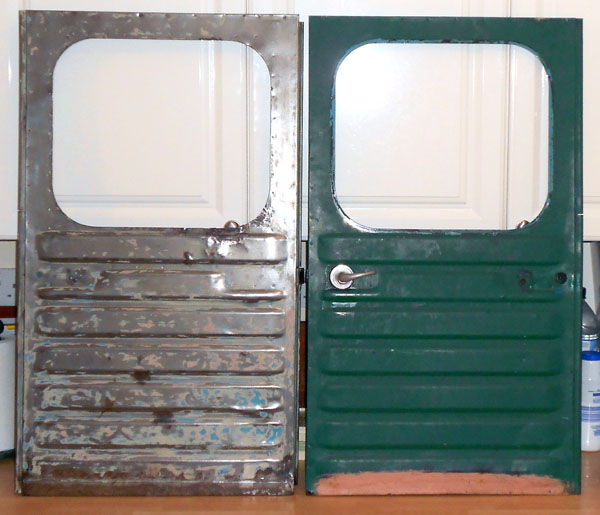

Look what I've been doing this afternoon:
One problem: Nitromors costs a flippin' packet, and as you can see I ran out before I finished the job.
For the other door I'd like to try a home made version. Would this work on car paint?

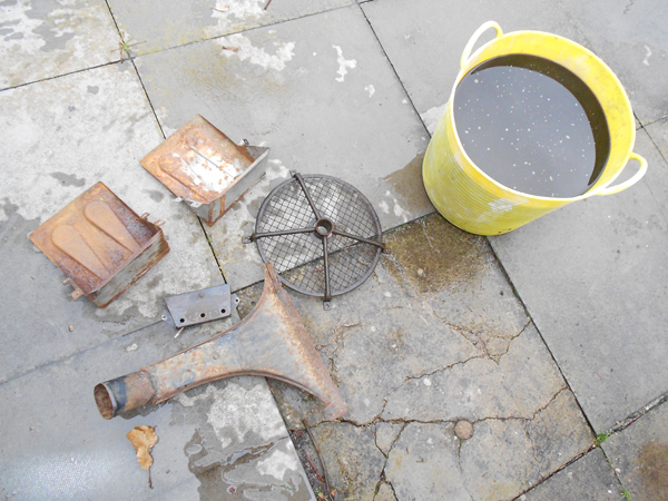

Three weeks ago:

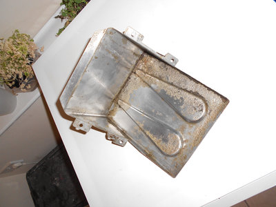

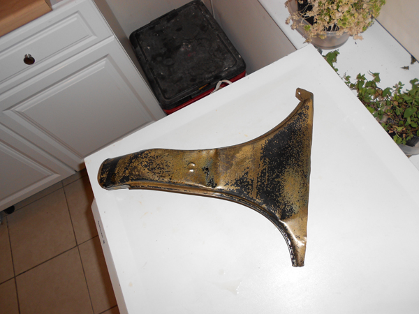

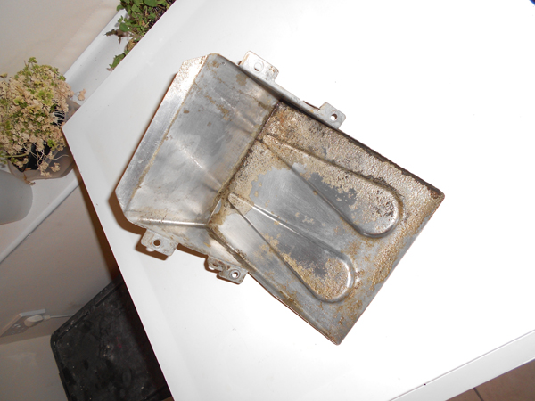

Well, 3 weeks after I dropped the rusty bits into the butt full of molasses/water, I just got them all out and gave them a light scrub with my trusty Lidl scouring pad. Amazing! The rust literally melted off, leaving pitted but very clean metal.
Probably the worst bits were the battery trays. They're now looking splendid, eg
(Note the bloom of rust already forming, just minutes after I'd finished - treat the metal immediately after cleaning!)
So now I've given them all a quick brushing of Fertan to protect them, and they're drying in the kitchen.
Conclusion: really easy and effective way to treat rust. Dump it in and forget it - the longer the better.

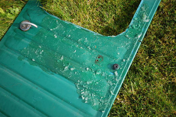

Right. Here is the report of my gloopy caustic soda, cornflour and water mix experiment.
The door that I worked on had been painted green. Here's a shot of it with some gloop on it.
The caustic soda mix caused the green paint to literally melt off amazingly easily. However, the original car paint underneath just would not budge! Most frustrating.
Now, caustic soda is a strong alkali - so I guess I'm just going to have to find an acid-based gloop to do the job on the car paint. My dad is a retired chemist, so I'll see if I can tap him up for a recipe. Will keep you posted!

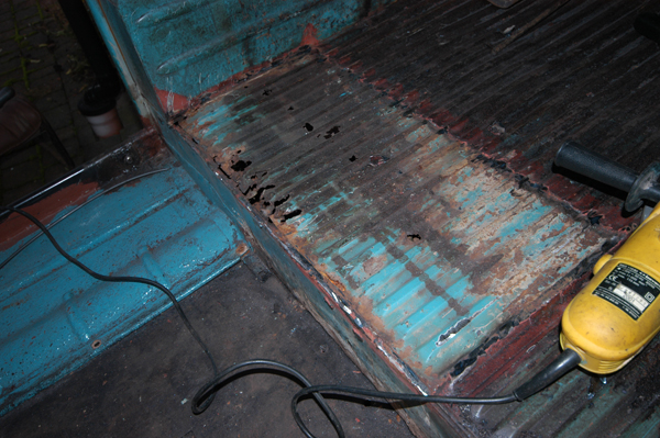

Emboldened, I then set about the rubbish patch-up job in the back of the van. Much grinding and cutting and tugging and swearing later I was left with this:
Now then - what would be the best way to sort this out?

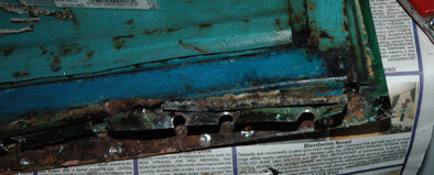

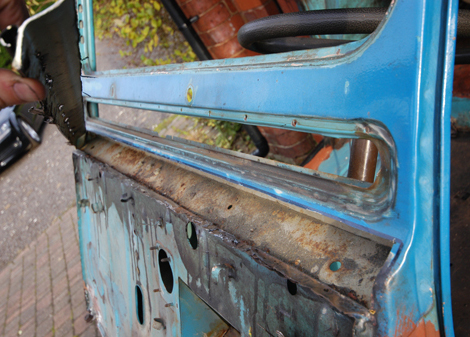

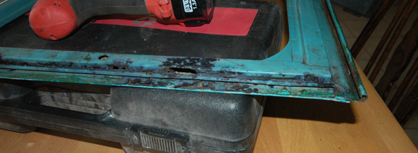

Couldn't go and mess about on the vehicle today, so I worked on the back doors. One of them is in a bad way at top and bottom

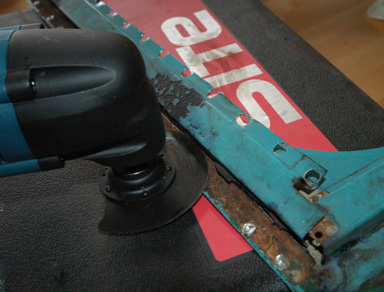

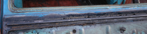

so I cut out the rotten pieces...
Anyone know where I can get replacement pieces for these, along with a rippled section of floor for the back of the van (approx 60cm x 30cm)?
Suspect Keza's my man for this, but postage costs might be prohibitive.
