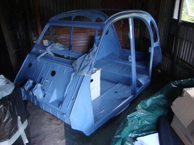

Time for an update then I reckon.
It has to be said that I'm obviously not a natural when it comes to this painting lark.
It's taken me 5 weeks of spare time to get the bodyshell to a standard I'm happy with.
There are some sections that I've done over and over again to get them right and there was one particular section that I took right back to bare metal and started again from scratch but in all honesty I'm over the mood with the final result.
One of the best things I've done was to buy an airbrush a couple of weeks ago. With this I can blow in very small areas rather than having to redo the whole panel.
There was a bit above the offside rear quarter window that had reacted with something. It didn't look like silicone fisheyes, more of a bubbling sort of effect. I took it back to metal with my trusty Dremel and airbushed high build primer until it was level with the surrounding paintwork then blew it over with a few coats of blue. After a quick polish it was invisible.

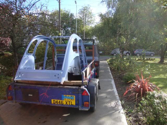

So with the shell finally finished it's time to move on to the rest. A mate in the next village had an empty garage he was willing to donate to the cause for a bit, so with the aid of a borrowed trailer the shell was dragged into daylight and transported very carefully to its temporary home. Thankfully we managed it without a single scratch.

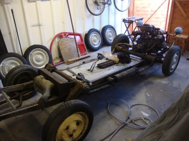

Which leaves me room to get the chassis in the garage ready for stripping and painting.
I'm intending to spray the chassis in the same grey as those lovely shiny new wheels in the background. All the suspension will be back to original black.
The mystery of a new oil leak that had developed over the last couple of weeks of the chassis sitting outside in the rain was solved when I drained the oil and found the engine was absolutely full of water (obviously with the oil floating on the top and leaking from anywhere it could).
I suppose it's come in through the air filter box and drained straight down to the sump. Thankfully it hasn't been like this for long so will hopefully not have caused any great problems. I should have the engine stripped down by the end of the week so I'll find out soon enough.
