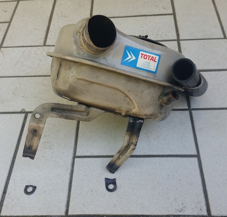

Well it's welded up again and as i was busy i gave it a good clean. Strange place tot break isn't it?

Air filter box. The vibration makes that, and when welded, it will broke again near the welding. When I had that metal filter box in my Dyane, tried to weld it, and got bored with welding that few times a year, again and again...
The solution what lasted more than enough, was to make new brackets from 5x20mm steel, with that it was strong enough to lift engine-gearbox by that filter box out of engine bay...

well that's an idea... ;-)

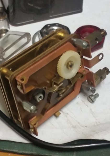

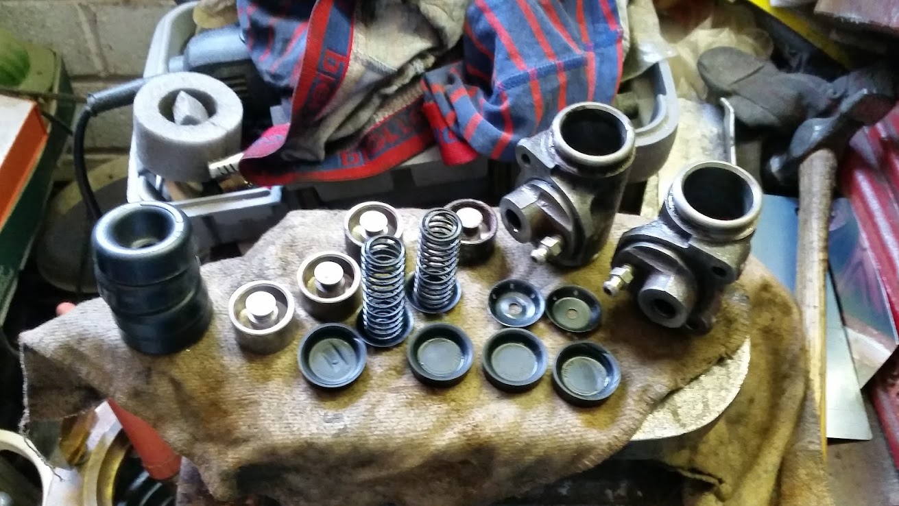

Had done a lot of work on the 55. Repaired the clockwork direction indicator, The wiper/tacho drive, cleand the carb, put in an other fuel pump. And rebuild the front brake cylinders as the car was braking only on 1 rear wheel....
