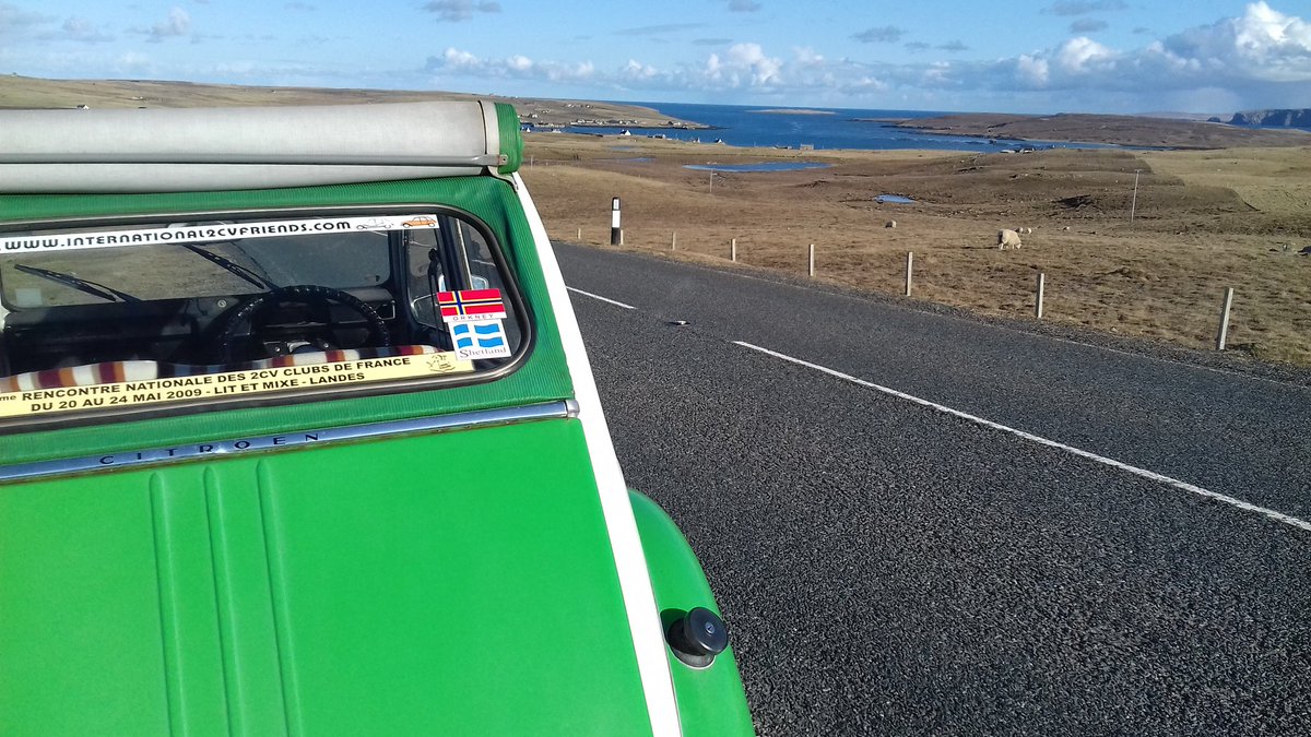

The 2CV was registered new on this day 29 years ago. I've been out for a pootle around the island with the hood fully open today. Absolutely glorious weather.
