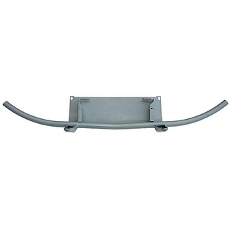

front bumper is not v-shaped but curved all the way and a bit more to the edges of wings.
May 15th, 2017, 8:21 am
Posts: 2251
Post Re: Van repairs

Fair enough, a PO bumper is like that but this isn't a PO bumper because I don't want it to sit so far forward on extended brackets. If it was an offroad van maybe :) It won't need the skid plate either, not with 12 hp to play with :lol: .
