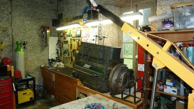

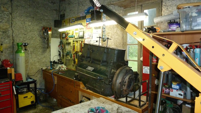

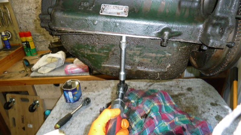

This engine is so heavy I cannot lift it, so had to make a small bracket and use the engine hoist to lift it and undo the bolts to the sump cover.

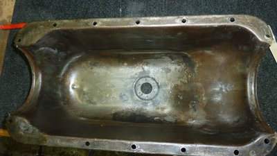

Managed to get them all undone with out bother. The sump cover has two metal surrounds to clamp the cover to the block, under the crap they were nicely painted in original green.

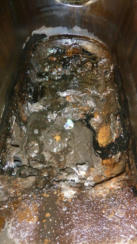

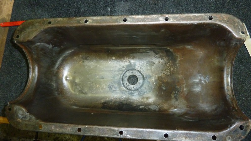

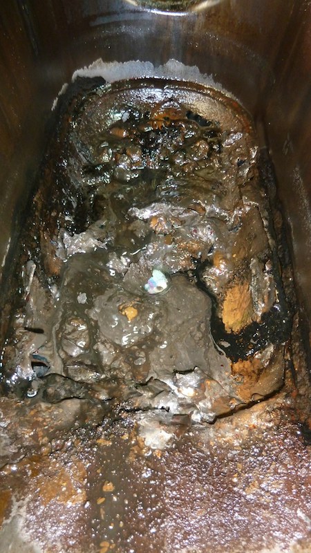

Inside the sump was a bit of a nightmare.
But after scooping it all out and cleaning it looks a bit better. There are some tiny little fissures (holes) in the base but they do not go through. Hoping these will be OK as the cover is pretty thick and sturdy.

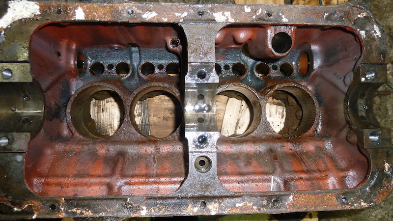

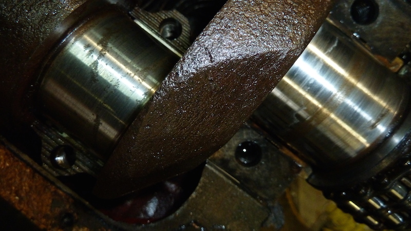

There is a bit of surface rust on everything but when I undid the piston rod the white metal bearings were shiny and the surface was smooth, plenty of depth left of them too. These are expensive to replace so I may have got away with it.
Looks like all the pistons are rusted stuck in the sleeves though :(

Yep - engine is upside down - that is the oil filter and pump.
Nightmare of a strip down so far - the pistons are definitely welded to the piston sleeves (jupes).

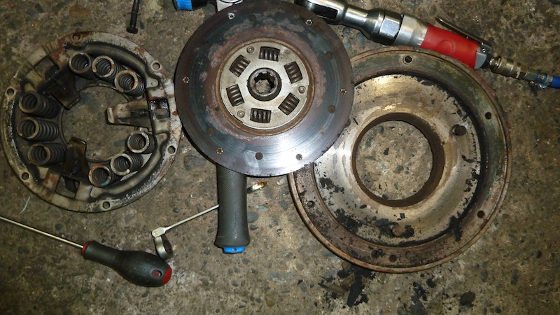

I had to try and reduce the weight of this monster so I could work on it.
So off came the clutch, in pieces, which I then spent a good 30 mins putting it all back together, but at least now I know how it works :lol:
I am hoping to get this re-surfaced along with my brake shoes.

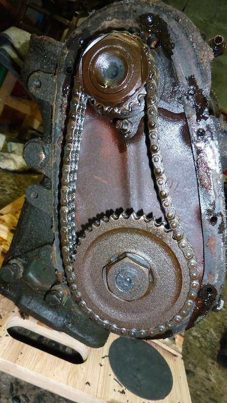

Timing chain cover next. I think this chain is a little slack. I am sure there is a chain tensioner device that is made for these now - I must investigate further.

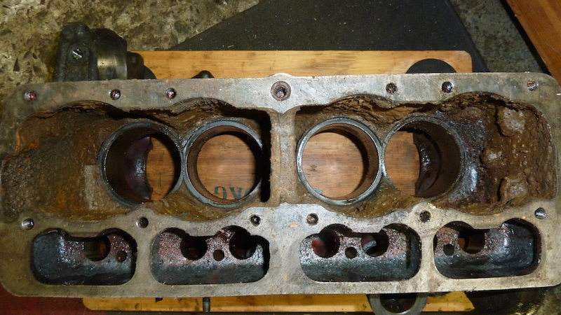

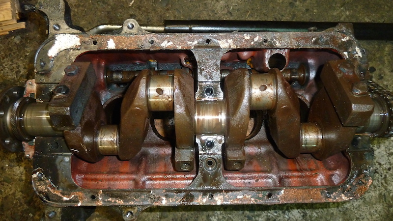

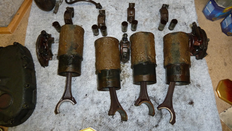

So off with the piston arm rear bracket (I need to learn the proper terms) and I then knocked the pistons downwards which in turn took out the whole piston sleeve. I think the bearings are fine, no scoring just a few stains - anyone able to comment on this :?: :?:

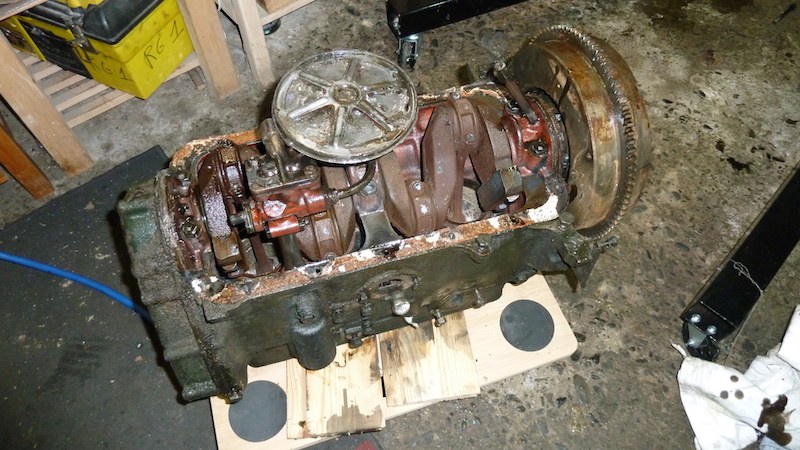

All the pistons and sleeves out now
Leaving an empty crank shaft. But now I need to take the timing chain off and remove the crank and the camshaft from the block. But I need bigger tools - 38, 40 and 46mm sockets to get these BIG nuts off.

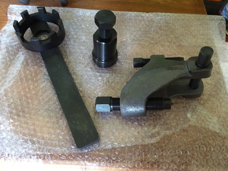

Must be my birthday today. Just received some new tools so I can start dismantling the front end of the car.

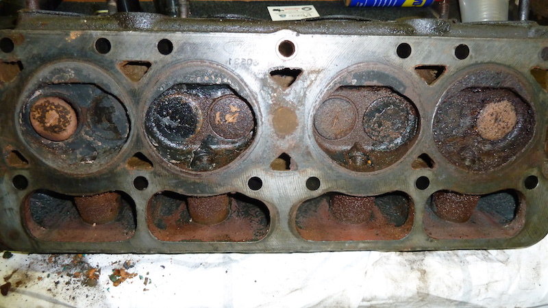

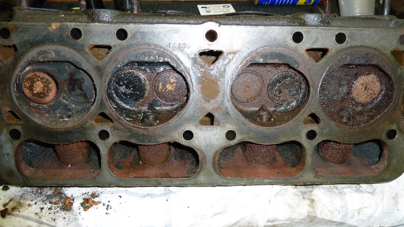

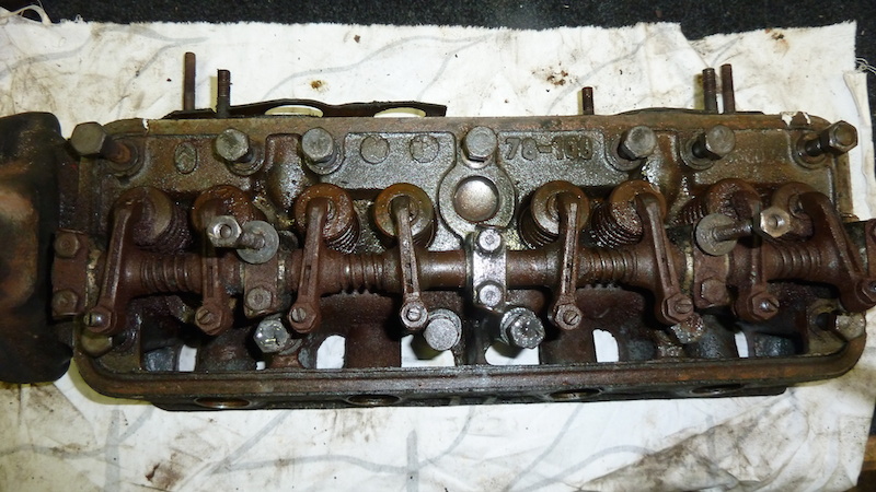

Some before shots before going. :D

I have left my engine with the to be cleaned, the surfaces inspected and levelled and the head to have the valve seats changed out for non leaded. They will also put in the piston sleeves for me :D :D
