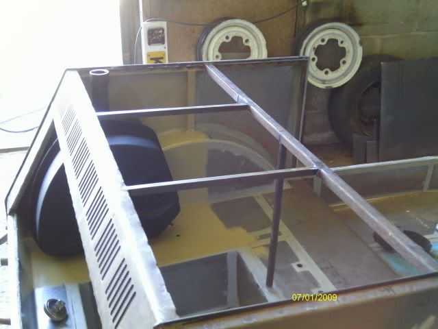

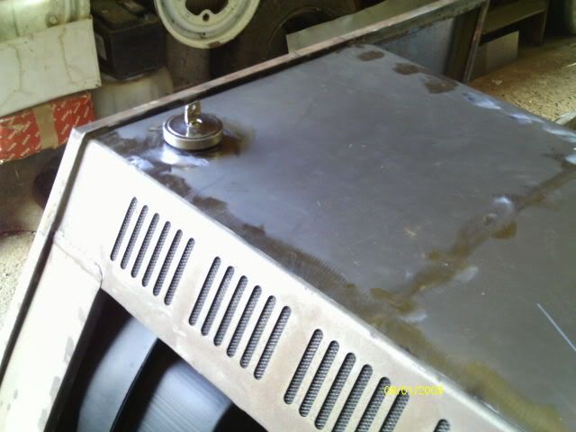

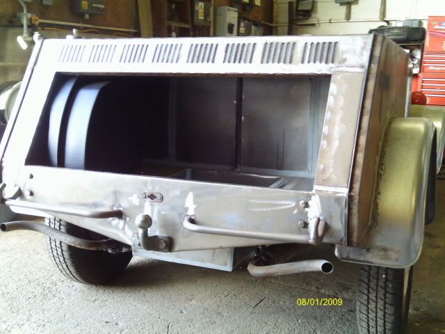

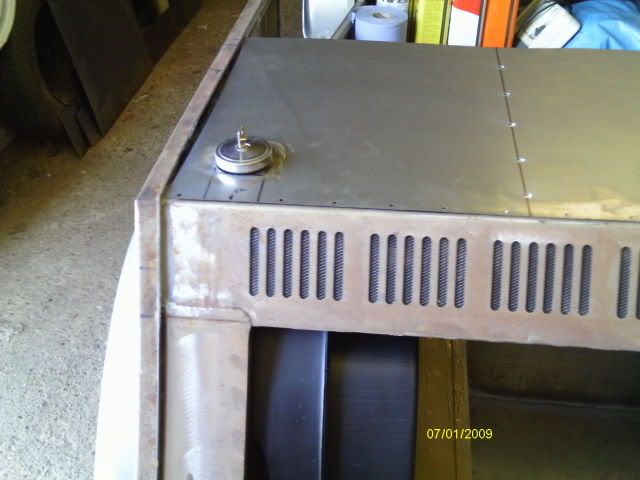

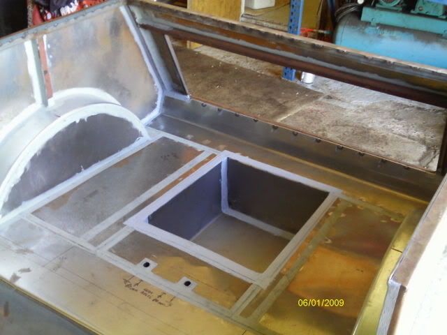

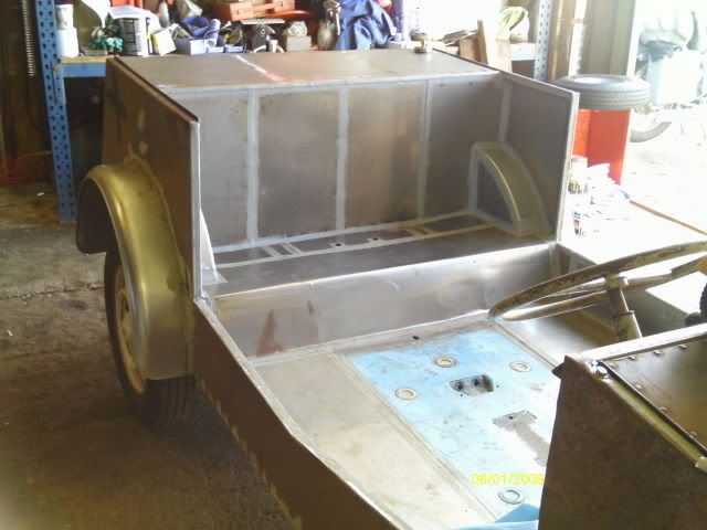

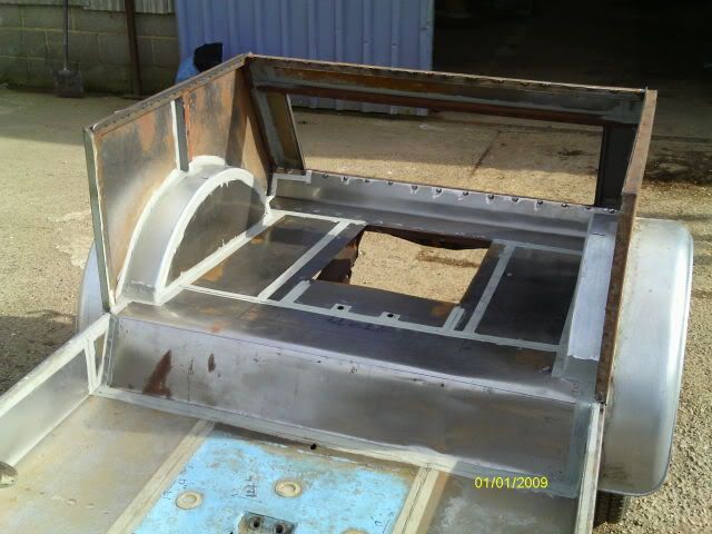

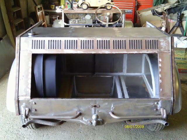

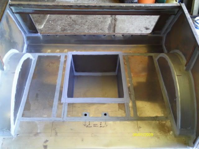

Boot floor done all apart from the drop tank which will fit in the hole left in the floor. This will be big enough to fit my trolley jack and all the other shite i carry in my normal car boot.

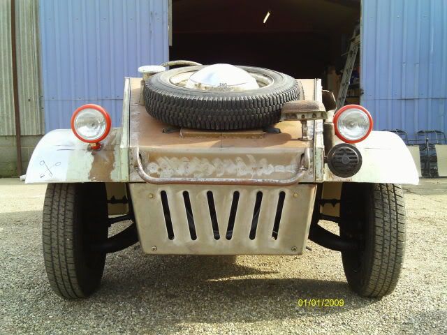

Got the front belly pan back from James 'the engineer'. He's made a lovely job of cutting out the air intake vents for me, Cheers James :D .
Got to wind the front suspension up as yet. Ive done the rear a little and would like the front to match 8-) .
More soon.

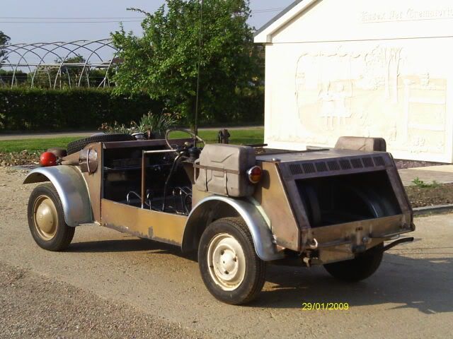

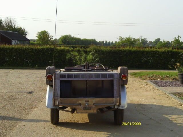

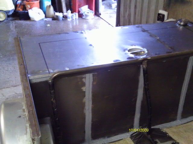

More done :D :D

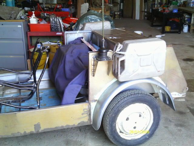

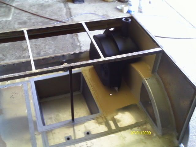

Fitted an Austin Mini fuel tank as it fits around the rear wheel arch a treat and allows the twin exhaust system to go where i want it to. With the original tank in place it would have got in the way of the exhaust. Ive gained extra space in the boot by sinking the box into the floor between the chassis rails. I will be fitting a 'fake' rear engine sump guard to this also so at a glance the 'box' should look like the original VW engine once i have painted it. :D :D

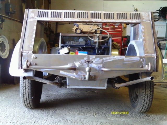

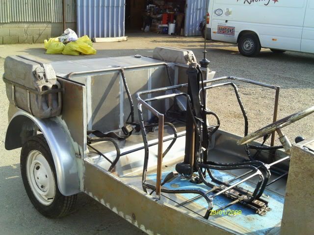

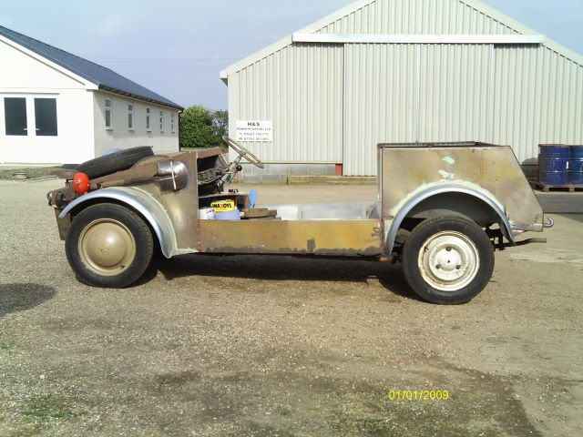

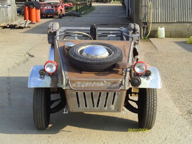

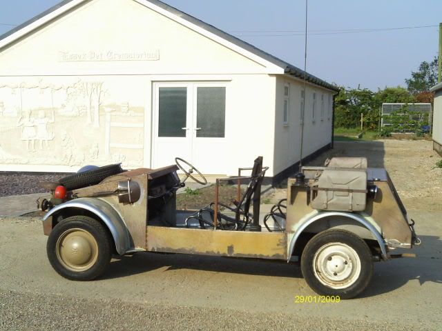

Took full advantage of the bank holidays that we have had here in England and got a shit load done on the 'Kubel'.
Anyway the photos show the story so far>>>>>

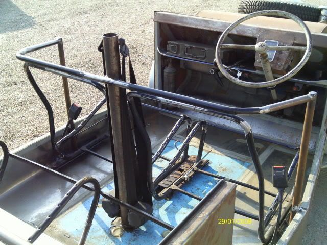

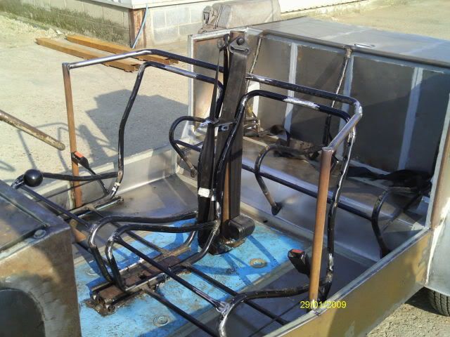

The tube welded in the middle of the two front seats is to hold a machine mounting for the MG34 type machine gun which will soon be adorning the Kubel. As luck would have it, it just happens to be the ideal height to mount the seat belts on 8-) :D :D

Jameswallace wrote:
saftey second.. ;)
unless Tony has placed the pipe all the way through the chassis and either strengthened the chassis internally or had a 'kin huge plate underneath.....i dont think that pipe can be considered "safety" in any way at all
Hoping it doesn't need a SVA test or even sees a diligent MOT tester :?

Post Re: Sudo Kubel
Thanks Sean. Yeah its a bit more secure than it looks, involving a lot of extra welding and plating etc, but to be honest, if i had a choice i wouldnt have fitted any seatbelts as it spoils the effect im trying to create. Unfortunately though the MOT testers dont quite see it the same way.
When im at car/military shows i will be hiding the belts with a camo net or jacket and german helmet etc.
Lets face it we all drove cars for many years without belts before thay made them compulsory.
Personal choice i guess.
One thing for sure is that the structure is a lot stronger than it was when it rolled of the Citroen production line ;)
