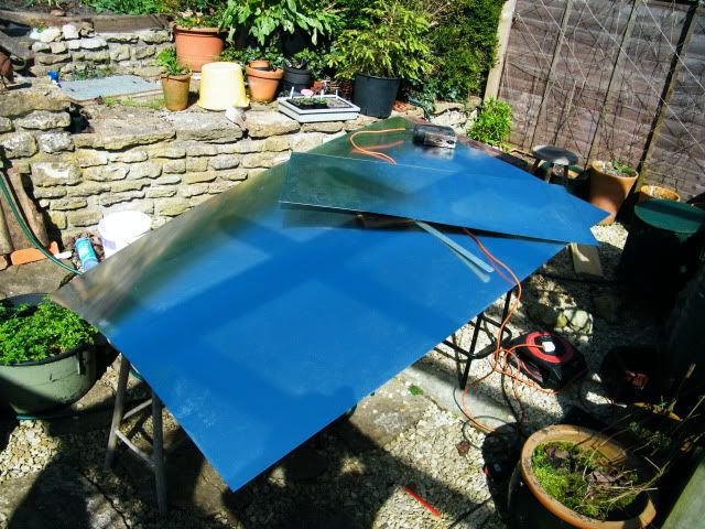

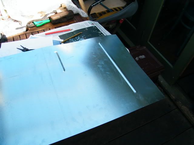

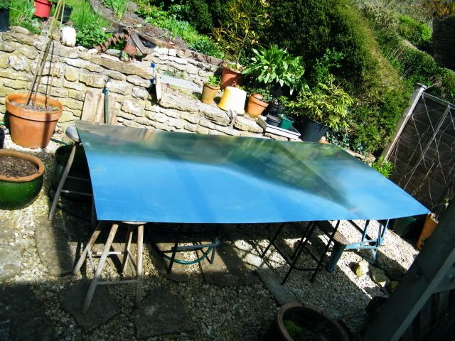

We picked up a sheet of steel from a local builders merchants, it's 0.6mm galvanised steel. The original is 0.4mm, but I felt a bit scared using metal as thin as that, and I'm sure the extra 0.2mm wont hurt. If I just grind / wire brush back or whatever the galv coating where I weld, I'm sure it'll be fine.
Andrew (On the 2cvgb forum) sent me a copy of an article from the magazine showing how to make a bulkhead, which I followed mostly until I got bored :P.

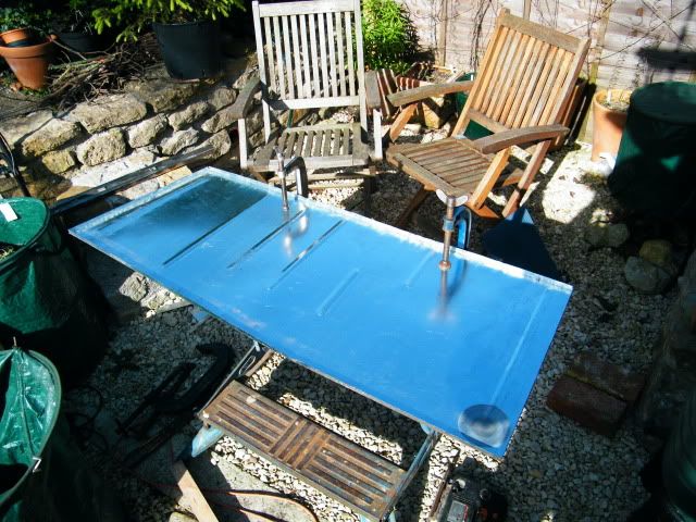

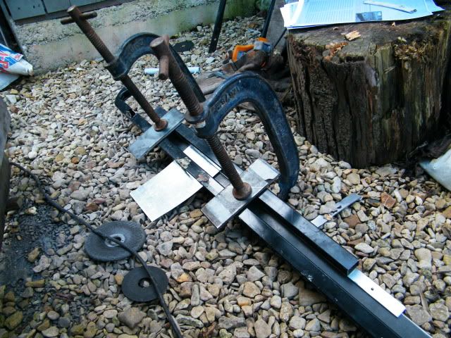

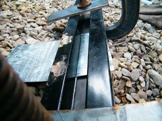

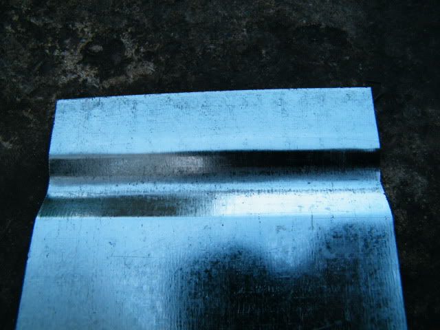

The main problem is pressing the 'ribs' into the sheet, and without it distorting too much. For my wheel arches, Paul (Again from the mig forum) showed my how to use his bead roller and so on, but for this I fancied doing it all myself, so I made a similar tool to that show in the mag article.
Hopefully you can see how it works? The metal sheet is clamped in the middle, raised up by about half a centimetre, then the 'T' shaped bar is hammered down on op of it to create the rib. The reason behind clamping it is so that the material where the rib is to go is stretched, instead of it drawing in metal from either side leading to distortion. This didn't work particularly well, but it's not the end of the world.

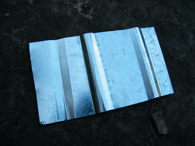

Here are a few pictures of my test pieces, to get the dimensions of the ribs correct.

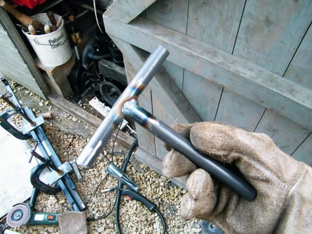

They seemed to go all right, the next problem was making ribs that didn't run off the end of the panels, but stopped in the middle somewhere. I remade the 'T' shaped tool from solid metal rather than tube, so as I could round of the ends. I spent an age with a file before realising a flap disc on the grinder did a much better job! Also, I made some curved pieces to sit in the tool, raising the level up to the same as the rest of the metal.
Then time to try it out on the real thing, it's surprisingly scary walloping an immaculate shiny sheet of steel with a crude lump hammer, but it seemed to be working OK.
There are the first couple of ribs done, they seemed to work all right. By the end it was looking decidedly wibbly though. :(
Well, the ripples are in place. It was 7 o'clock on a Sunday by the time I had got that far, and Mum insisted I give the neighbours a break. :roll: Monday was spent hitting it some more, I've got a lot to learn about metalworking! I was trying to round of the ends neatly, but it's still not perfect. I don't know how the metal behaves yet, and I can't tell which bit will pop up out of place when I hit a different bit, but I think I'm getting there.
