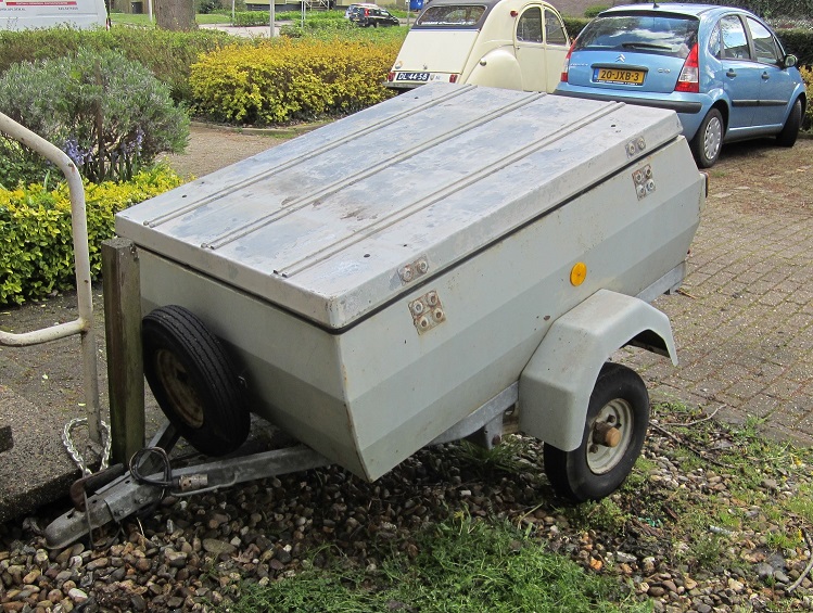

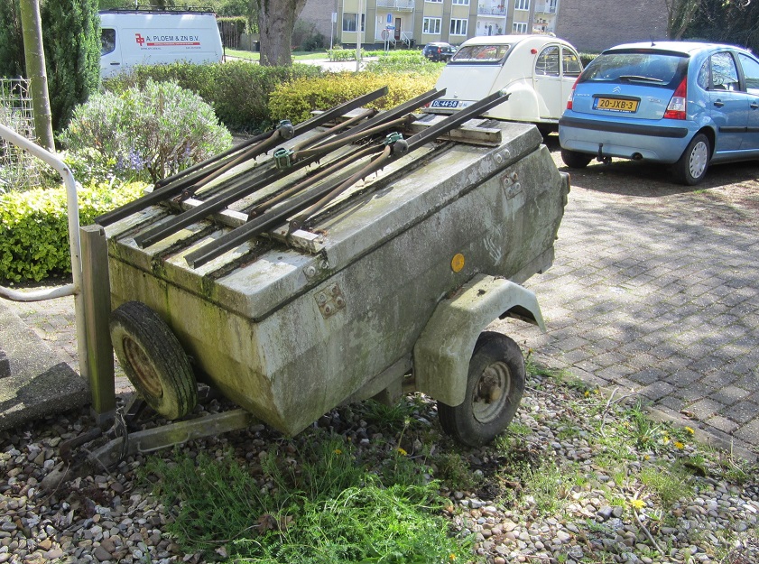

Today i got an old DDR trailer from a friend. Usefull for the holliday as we don't have the caravan anymore. It has been outside for several years. So to begin i had to pressure wash it. It will need new tyres, new cables and plug. And a bit of paint for the esthetics... ;-)
There was a bicycle rack on the top i took off, not original and heavy.

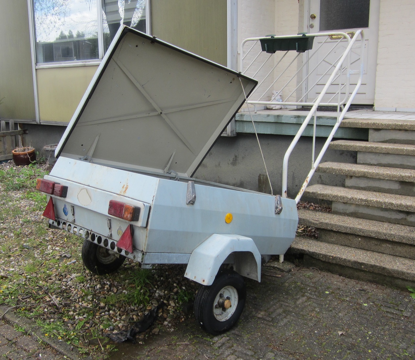

Did some anti-rust proofing today. After wirewheeling there were two small holes in the front floor part. The lid doesn't close well on one side. i think the hinges are a bit bend. Looks like the lid has been opened to far.
April 29th, 2023, 3:11 pm
Posts: 2290
Post Re: AZL 1957
Adjusted and welded the hinges, it's better but not perfect yet. Two wheels are off and prepped for paint. The tyres broke when i took them of. Thread was still perfect but the sidewalls dried out. A new set is on the way. New cables and plug prepared. 350 kg loading capacity. I will take the hubs of to regrease the bearings.
