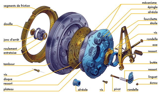

Could be too. Here nice drawing of the centrifugal 2cv clutch.
