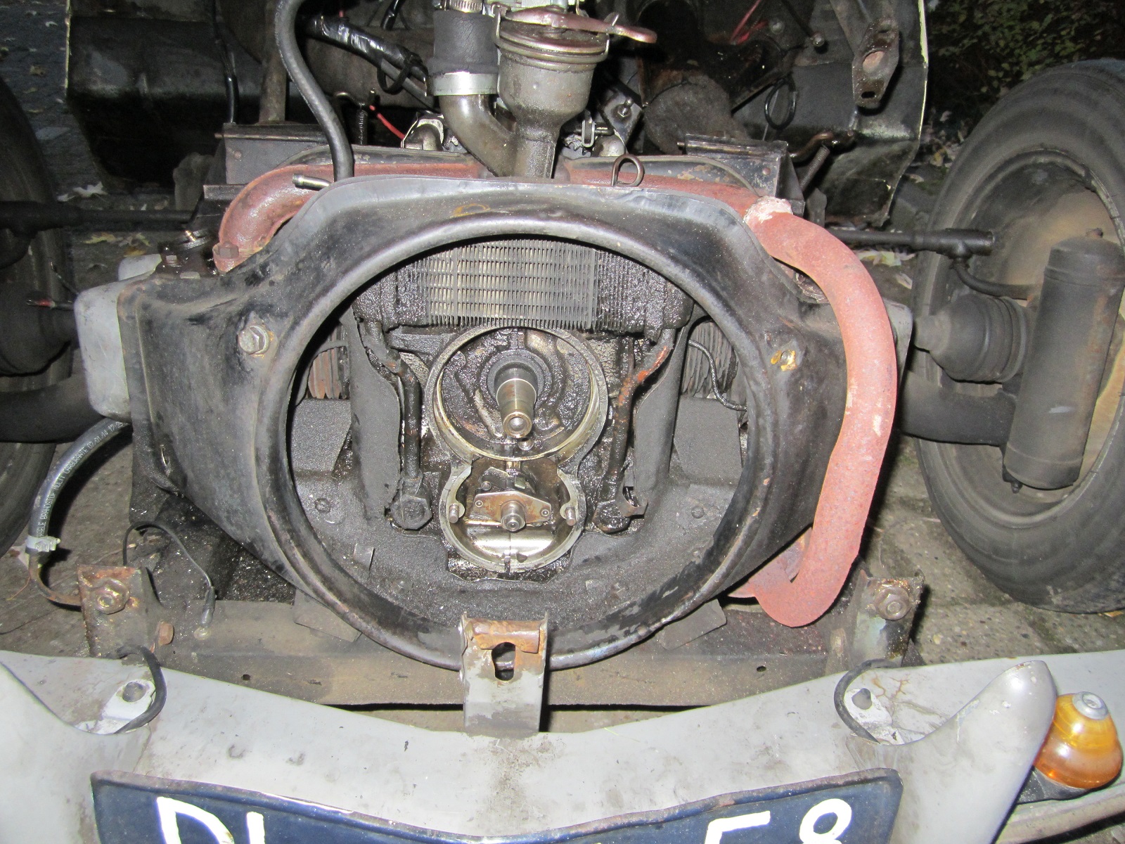

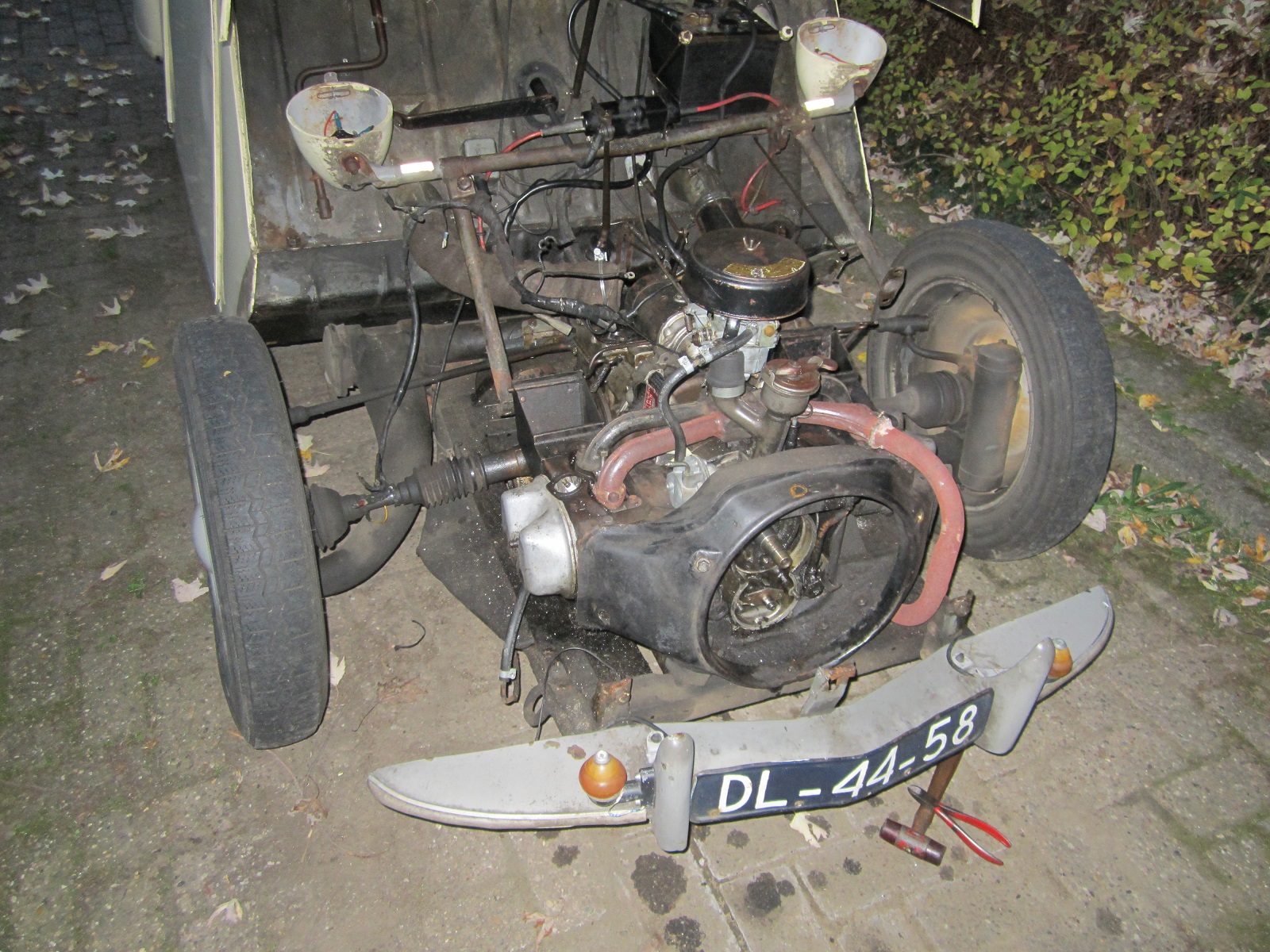

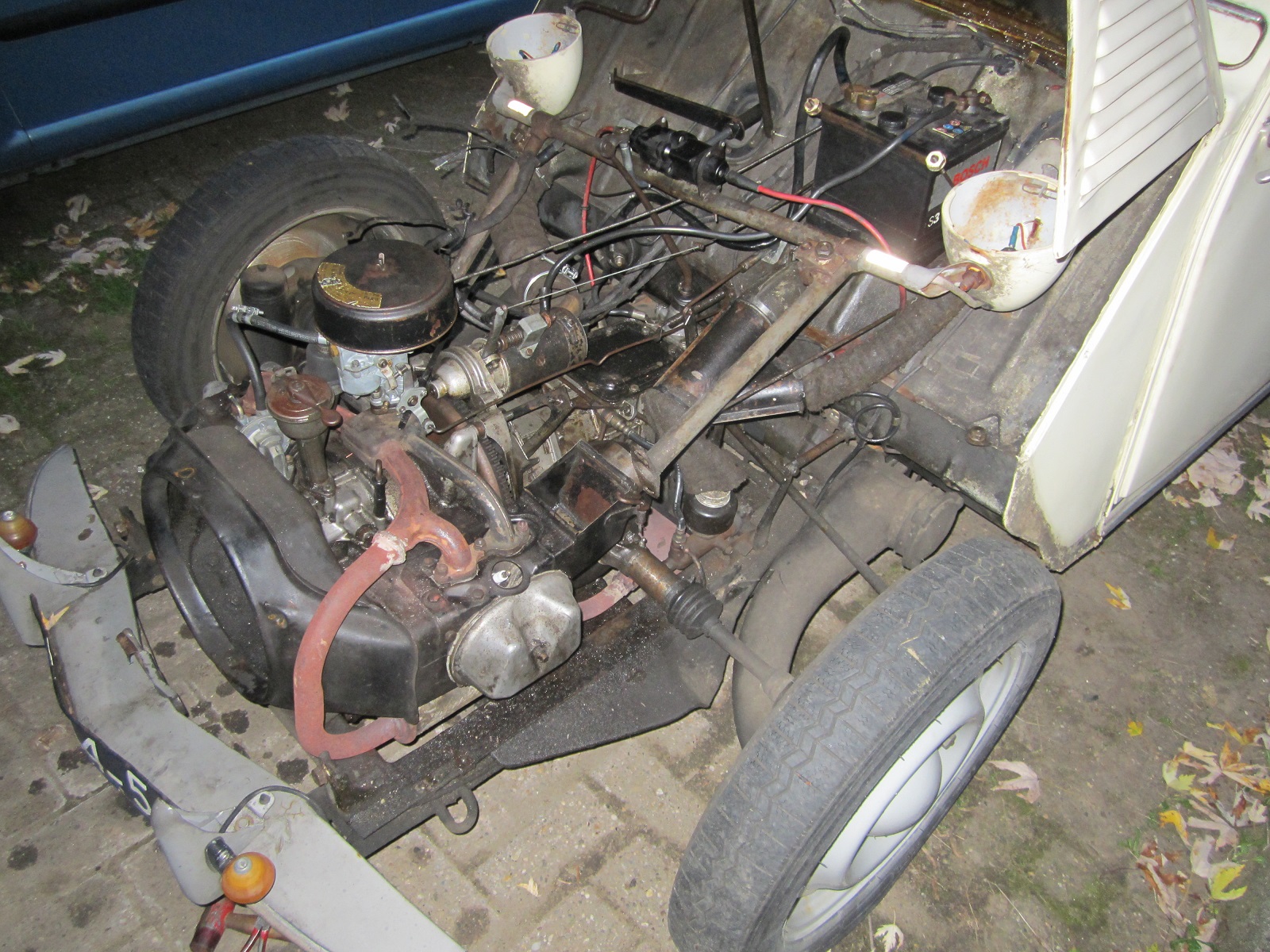

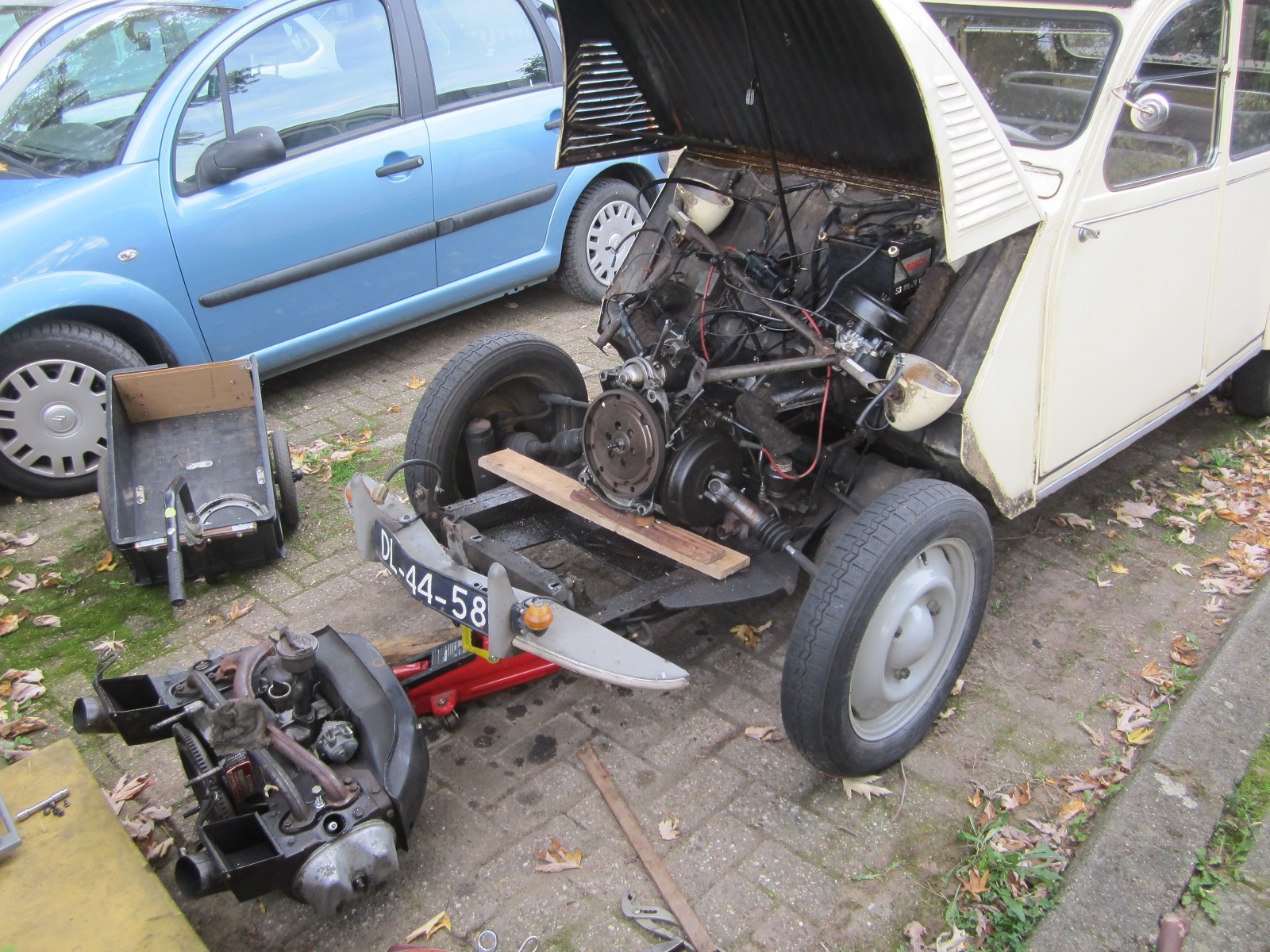

I just prepared the deuche for the engine swap. In the picture it looks less greasy than it is. There are only 2 nuts left holding the lot together.
October 27th, 2022, 7:07 pm

halfway

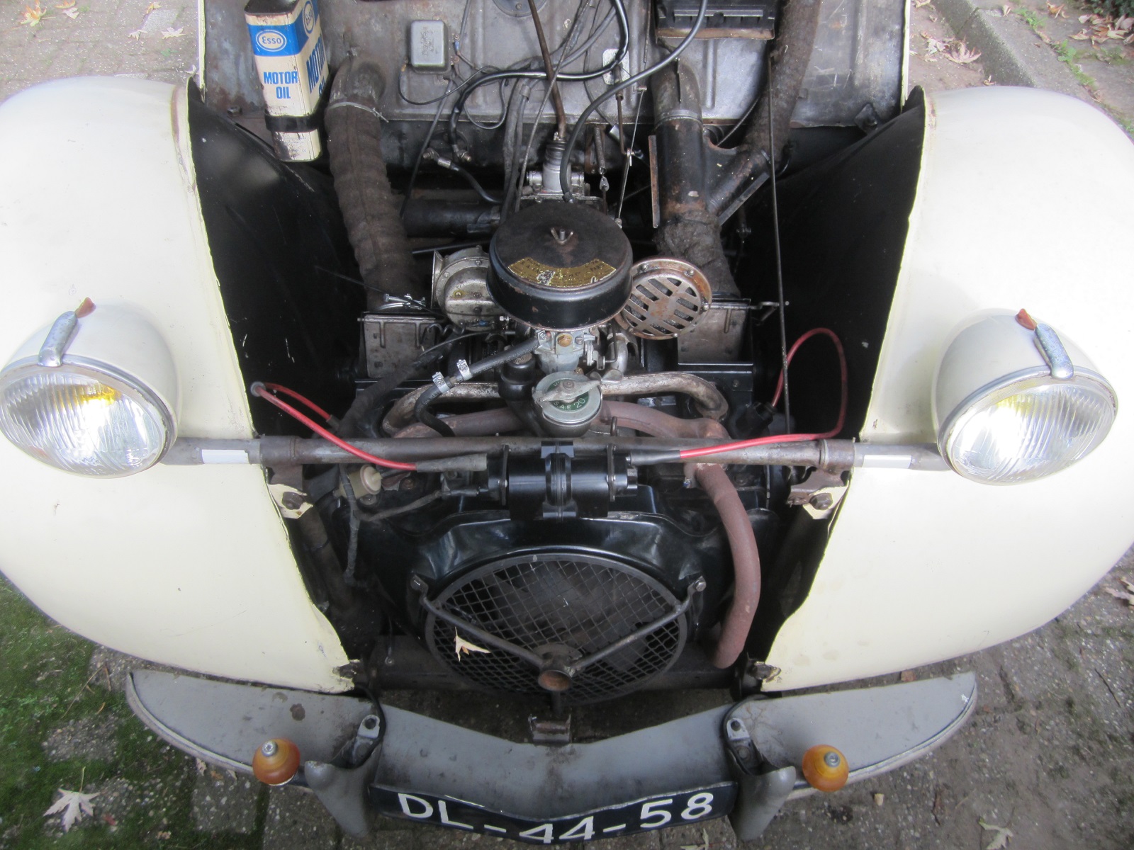

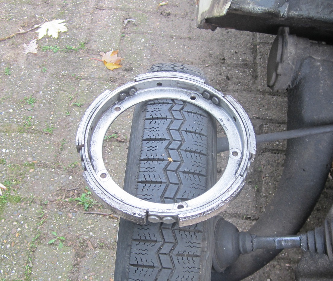

It took 2,5 hours to take an engine out, and put everything back and connect up. But it now has a shiny engine for the first time. It's my first deuche with the green oil advise plate on the filler cap. The centrifugal clutch came from a french fleamarket for 20 francs...
The engine i bought from an camping owner in france for 75 euros.
