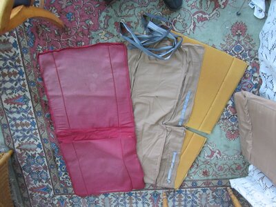

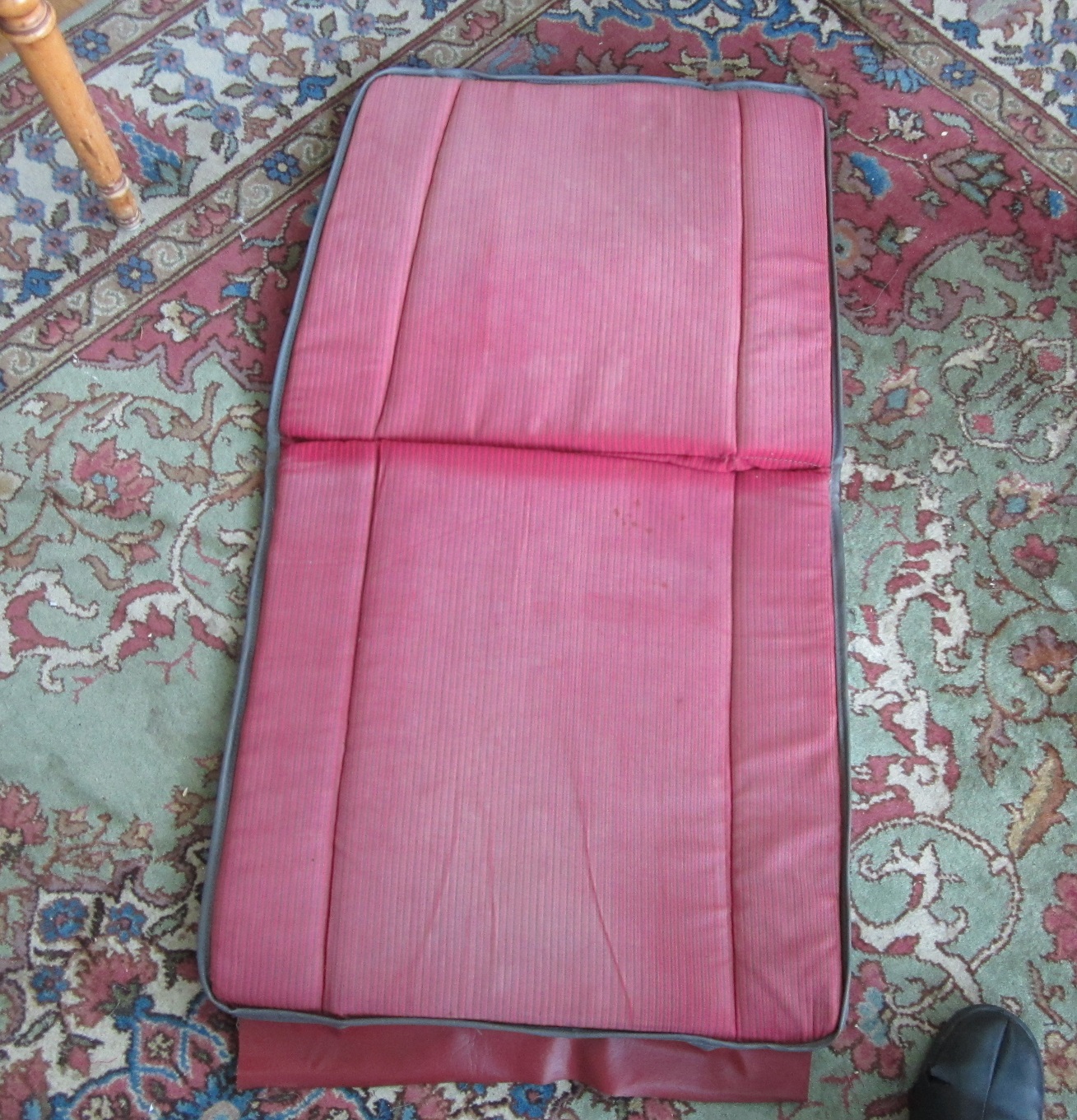

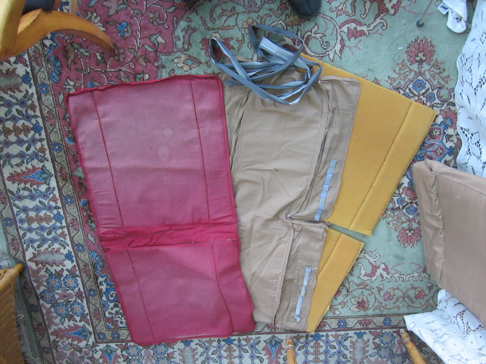

I am taking the seats of the green 57 apart. The fabric is desintegrating after 34 years of sunshine. The fabric used was old stock, the upholsterer in France bought this from his collegues. At the time new fabric wasn't available. So the stuff might be even older than 34 years. It takes about 1.5 hours to take one seat apart. Some parts were sewn 4 times. 2 down 2 to go. I have to get the car in the garage as i have only one seat left in it... The ivory 57 has to resume work this weekend.
Here are the seats before and after.
