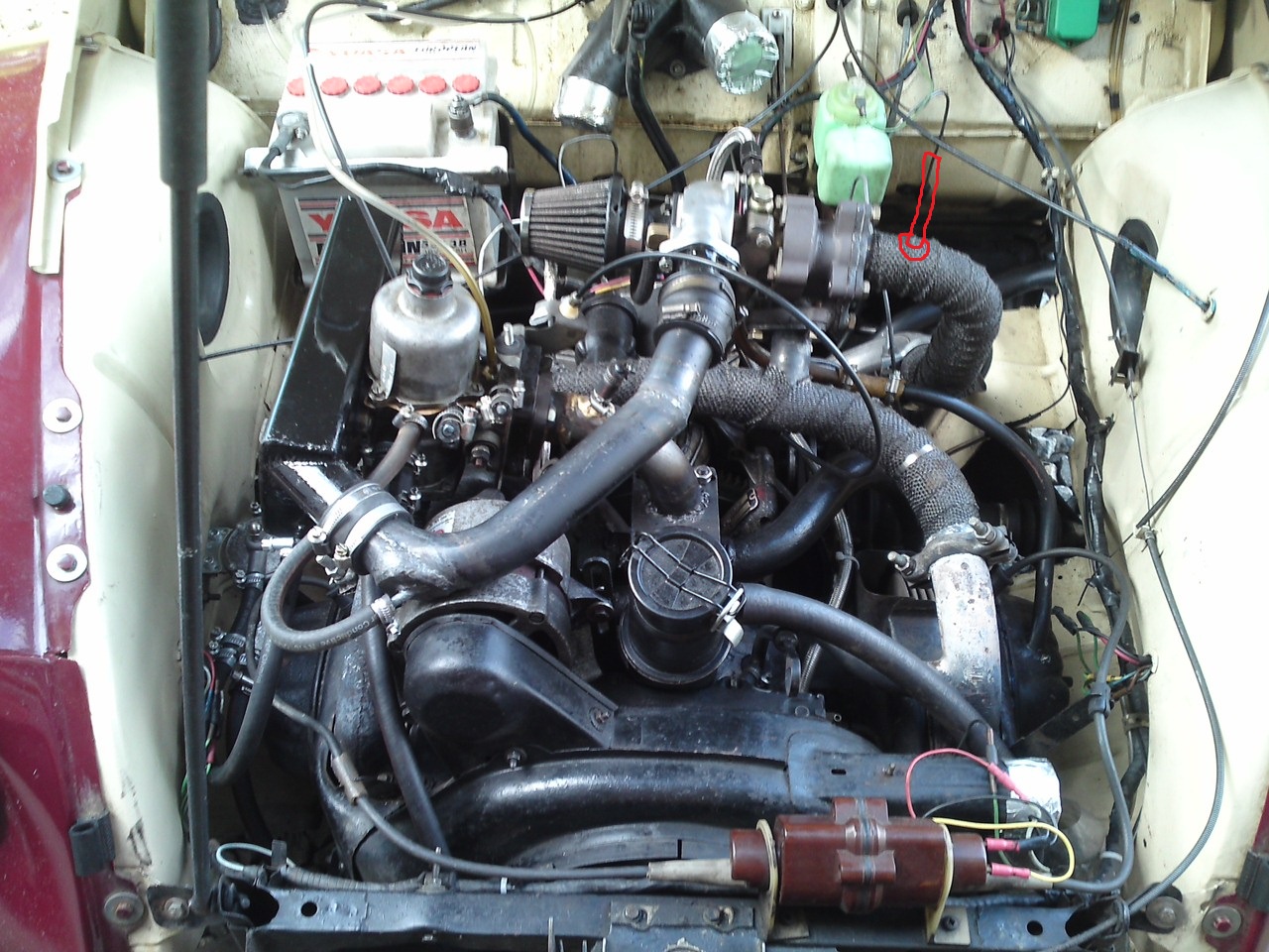

I would put the lambda probe after the turbo at the red marked spot (looking at your pictures)
