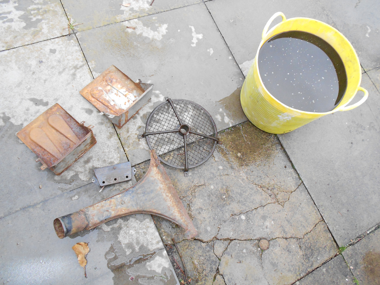

Stripping off a load of rust from the various detachable parts. Got cheesed off with scrubbing and sanding, so I went to my local horsey supplies store, and bought 5 litres of molasses.
Mixing this stuff at 1:8 with water is meant to create a magic rust-stripping mixture.
So I dumped 2 litres of molasses (which tastes great, by the way) into a tub and mixed it up with the required amount of water, cackling like a witch as I stirred.

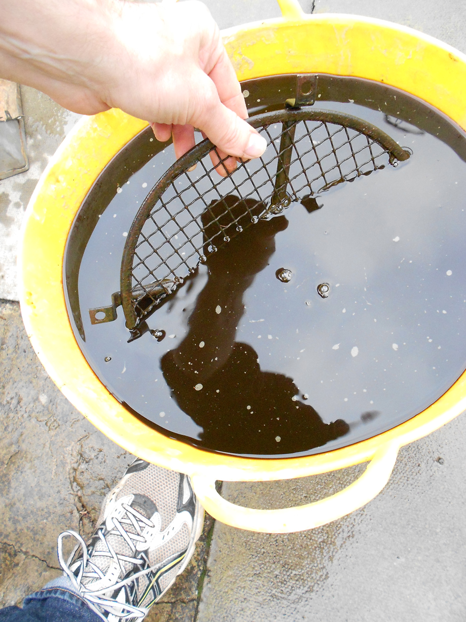

Next, collected the rusty bits...

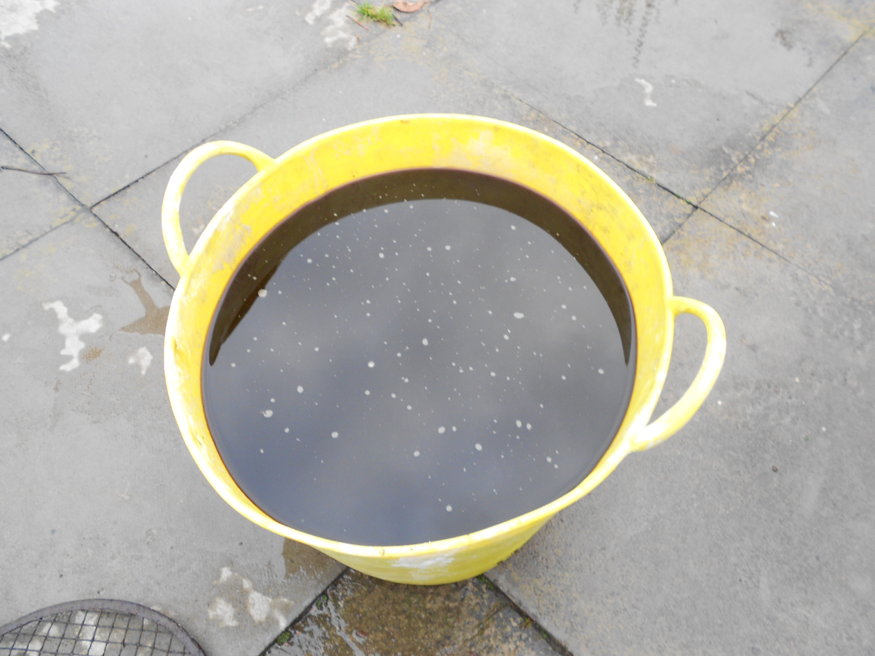

... and dropped em in
I've now left the bucket full of rust to fester in the shed for 5 days or so.
