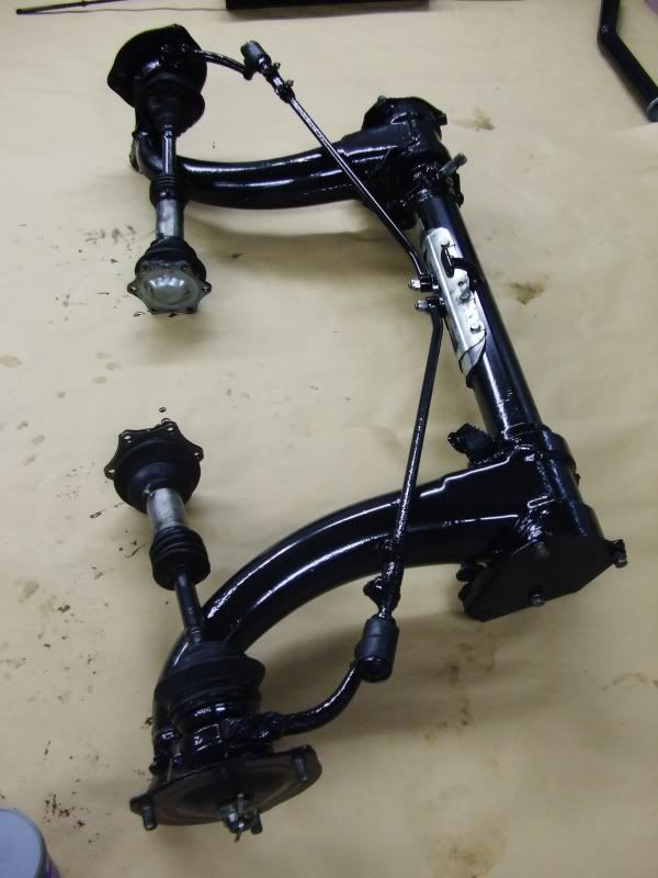

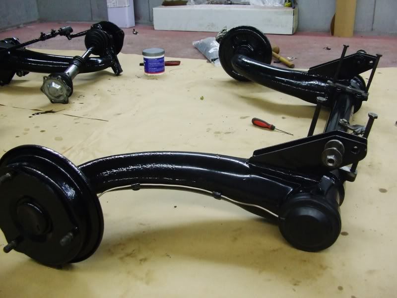

Teeny bit done this morn, fitted up a few bits to the axles, did the brake pipes on the rear.
Till next weekend folks!

Is it my eyesight, or has the anti-rattle rubber on your steering rack escaped? :?

I take it that's the rubber piece that sits under where the track rod arms are bolted? if so, it's your eyes Ken ;)
