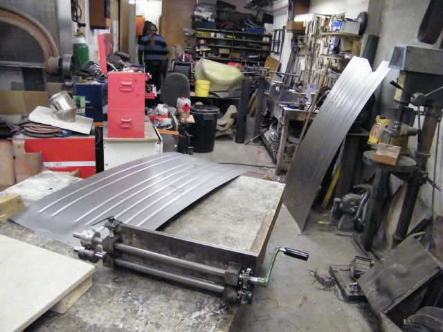

My wheel arches are happening!

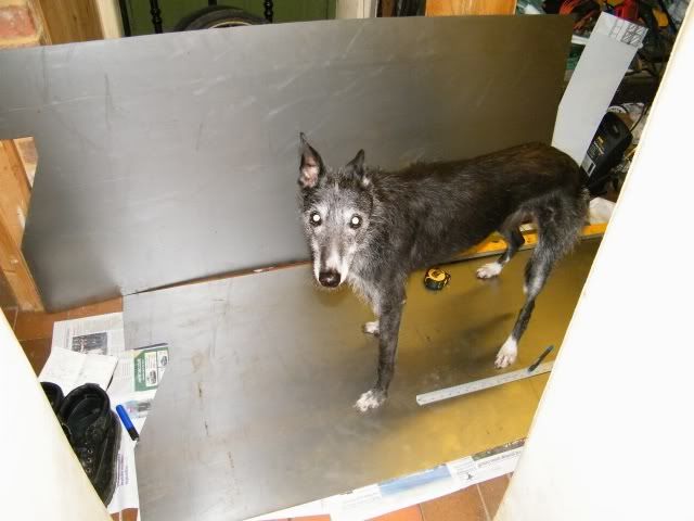

It took a while persuading dad to try fitting 2 sheets of 2 square metres of steel into the car, but we managed it in the end. Then I spent 4 hours outside in the rain with an old jigsaw cutting it up. :?
Then spent an age marking it all out. The dog helped.
And through the mig welding forum found a great chap called Paul in possession of a bead roller and much knowledge. With whose help this was achieved;
And this;
Now I have a nice stack of shiny, rust free ( :shock: ) metal, waiting to go back in the van.

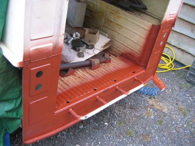

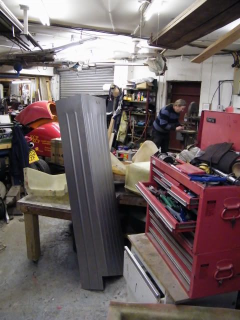

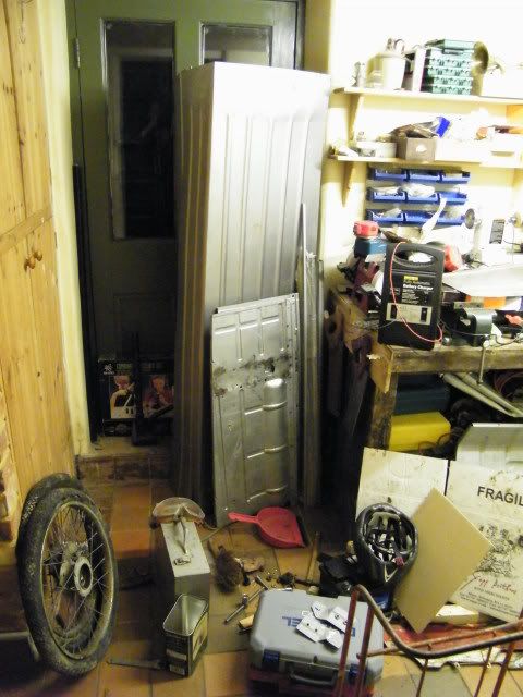

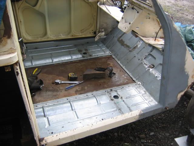

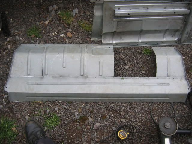

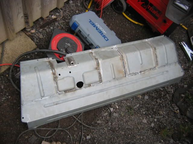

Managed a little bit more work this week, all that preparation paid off, I now have one new sill, two floors, and a right hand drive bulkhead fully welded in place. The other sill just needs a smidgen of welding, and the 'a panels' folding around the bulkhead and welding in etc. And to round it all off, the sun came out!
Warmth! Light! I had forgotten they existed!
Converting the bulkhead to RHD was interesting, I looked through some pictures Sean and posted ages ago, where all the holes on one side were covered, and new holes made on the other side. Then I had a think about how I could add a lot of totally unnecessary complexity to it, just to make my life difficult.
This was the solution I came up with;
:roll:
Fortunately it worked out OK, but I'll take the simple option next time. It was truly terrifying attacking £71.85 with a large angle grinder. :?
Then of course, I had to bridge a 1mm gap all around when welding it, due to the thickness of the cutting disc. And wait 5 minutes after every inch of weld to prevent it distorting like crazy. But it's all done now!
This is a bigger project than anticipated! :lol:

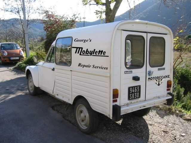

I know it's still a long long way off, but can I have some opinions regarding colour?
I wondered about the same colour it is now, with maybe a logo or something on the side (See below :roll: )
But I also like the grey/blue colours, I'm thinking 3 bar grill, chevrons on the bonnet, narrow headlamp bar, possibly bumper overriders...? 8-)
I'm not really very fond of the rectangular headlights, but it seems a bit silly swapping them for round ones as I've got a perfectly good pair (Actually, I think two pairs) of rectangular ones...
And I'm not sure advertising my mobylette services on the side would work as well in blue.
I like these two, see at the national;
Opinions please - discuss! :D
