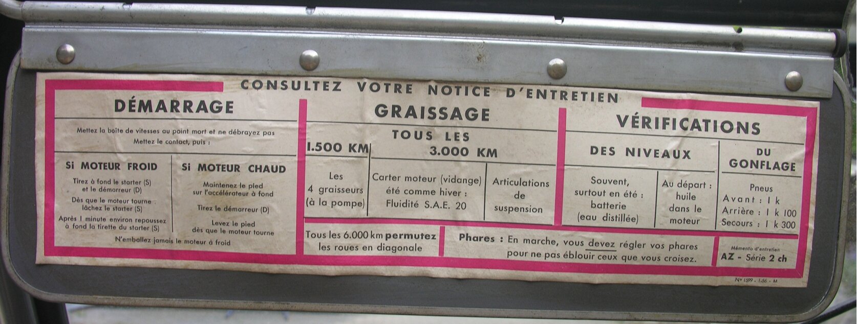

1.4 front and 1.8 rear. But on the sun visor is marked 1.0 front and 1.1 rear.. But that was for the Pilote tyres. I once drove a 2cv with pilote tyres, the suspension was even softer. We drove the cobblestones in Liege. You didn't feel anything... Only downside the softer tyres wore faster than the X-tyres.
