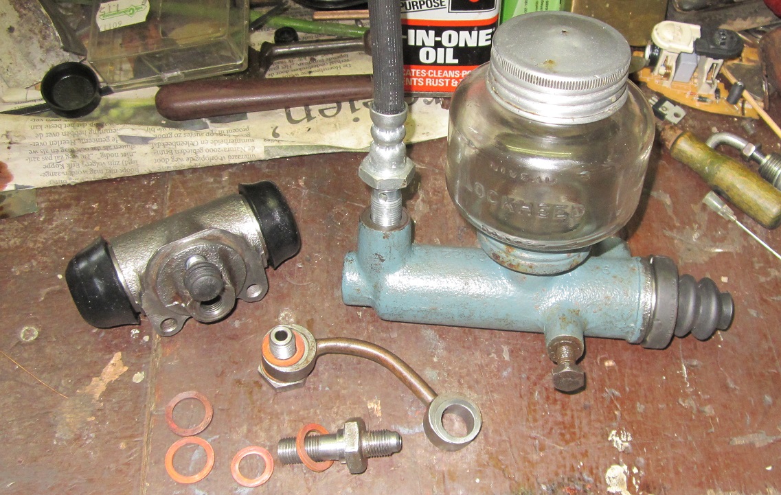

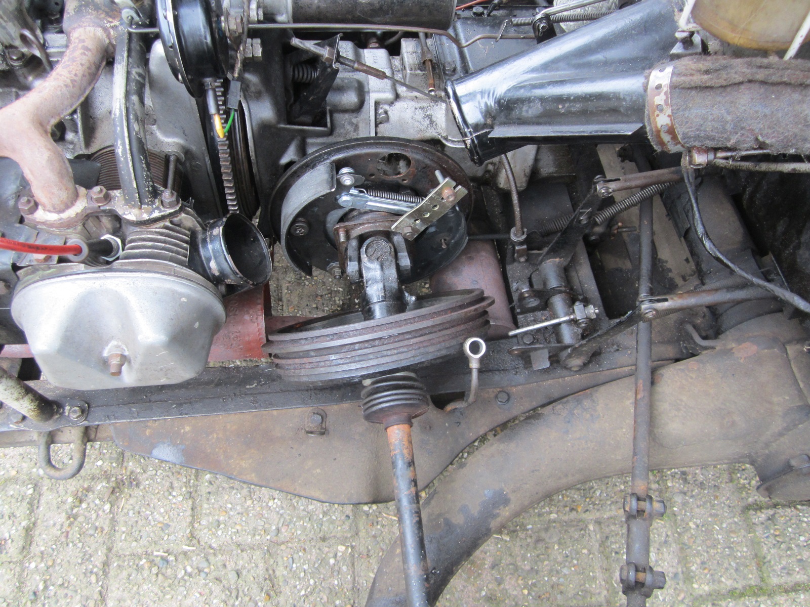

Well the green one pulled sometime to the right so i took the left brake drum off. The wheel cylinder was leaking and the brake shoes were greasy. As it was easier to work i removed the master cylinder and yes that was leaking too. There was about 5 mm of braking fluid left in the reservoir. So i took all apart and cleaned it. New brake shoes are in. Then i had enough of it. The hydraulics will be put back in later... Pffff

I had all build back and bled the brakes. The brakes are not worrking first i had a bit of feel in the pedal. But while pushing on the brake i did see airbubbles coming up in the reservoir??? I did bleed again but now no feel in the pedal anymore. But after 3 hours fiddling with the hydraulics i was fed up. So il will try later again with beelding all round again.

could it be one of the wheel brake cylinders faulty ?

It's all possible, maybe there is still some air in the lines. The first time i bled the tyre didn't have much pressure so the air might only be moved a bit down the line instead of out??
So i will try it all over again.

YES, it brakes again. I think i didn't have enough pressure on the easibleed. So it din't push out 2 large pockets of air in the rear brakeline. It is a lot thicker than the 2cv6 brakelines. I did have to adjust the rear brakeshoes a bit. Pff happy.
