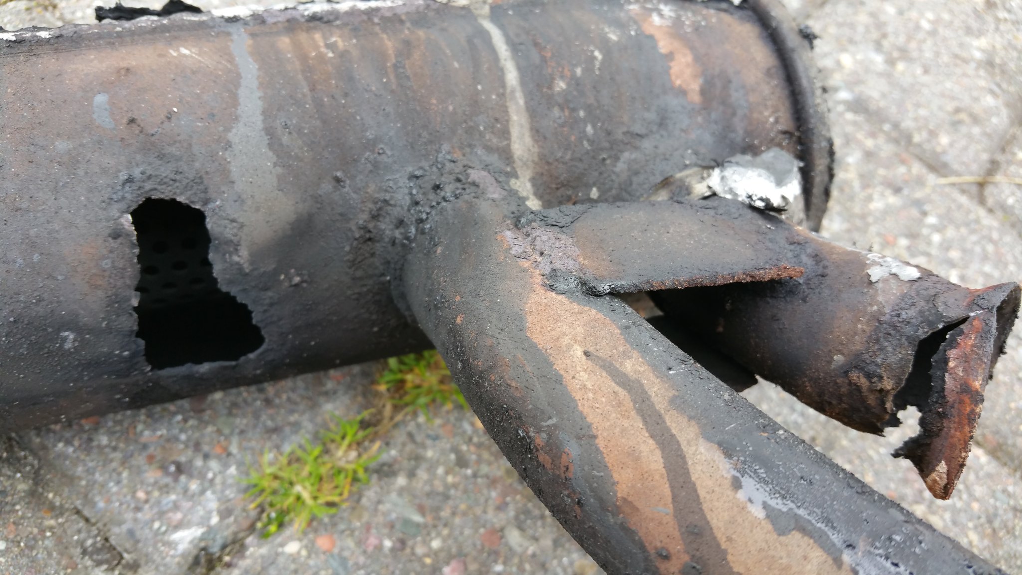

Spent a bit of time with the exhaust putty and the crossbox earlier. Have managed to block most of the gaps and improve things somewhat. If I was down in Worcestershire I'd just make a trip to ECAS to buy another one, but I've learnt how much more difficult (and expensive, and delayed) delivery to the Shetland Islands is, so just not worth the effort. It'll wait till September when I'm next heading down.

You could try cutting some tin cans and big jubilee clips with the sealer etc.

True, I'm sure I could cobble something together, only needs to last till Sept. The main test will be the drive from Aberdeen down to Worcester, but it doesn't matter too much if it starts to blow on the way down. In the meantime it only needs to pootle around Unst, Yell and Fetlar, and maybe a trip down to Lerwick. At least the oil leak is (currently) dealt with.

Bit of an update. Felt sure the exhaust was blowing far too loud to just be the crossbox, so today I decided to take another look. Turns out the two nuts holding the manifold to the cylinder head on the driver's side(RHD) had worked loose. After fully tightening them up the engine is much quieter, and the car much more pleasant to drive. Crossbox still needs replacing soon though. :lol:

Was hopeful the exhaust crossbox would last till September, but..... :lol:

Almost serviceable!

Almost. :lol:
Anyway, new crossbox fitted along with new clamps. Have been using it to pootle around the island and the odd day to work. Used it to pop down to Lerwick last week, a round trip of about 120 miles. I'm booked on the overnight ferry to Aberdeen on the 27th and heading down to Worcester to get it MOTed. Fingers are crossed. Once it has a fresh MOT I'll be popping over to France and hopefully head down to the far south. :)
