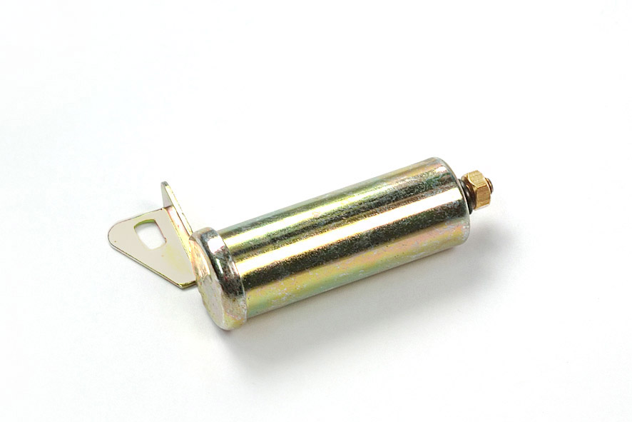

Post Re: AZL 1957
CAPACITOR.
I've Been Wrong Before.
February 26th, 2022, 6:59 pm
Posts: 2290
Post Re: AZL 1957
can try. But i need this model.

Well no result, even with 2 paralel capacitors no change. It revs up a bit but it feels like it is being hold back. Options left, a loose or not working cam for the contacts. A broken valve spring or a burned valve? It normally starts at half a turn but now starting is difficult.
