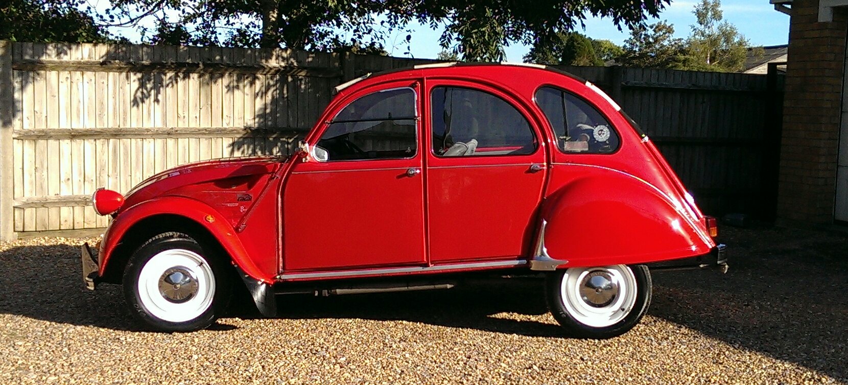

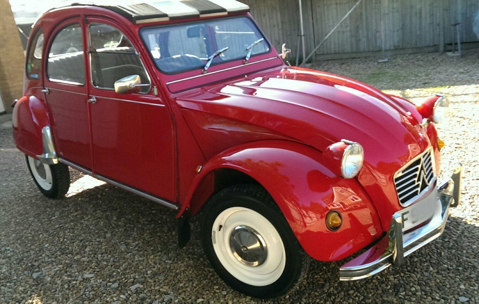

Annual big clean today. Everything out of boot and interior. Unfortunately there's a bit of rust in the boot now, I used to regularly take everything out of it and spray it with WD40. So it's held up well and it's only the light panel join at the rearmost end.
Greased the king pins and driveshafts and knife edges the other day. So it's feeling like a million dollars after today.
Anyway all ready for winter, if a little early. Anti condensation products applied to windows and locks well oiled so they won't ice up. WD40 sprayed anywhere it might help with dampness.

You can tell that everything's out of the boot.
That @rse end is right up in the air... ;)

Everyone likes a high arse :)
I do wonder if the nose has come down over the years though. I'll have to try and find some old pictures to compare.
