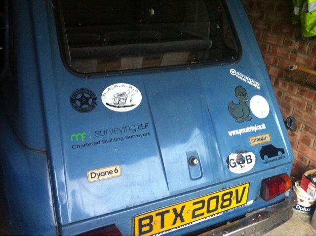

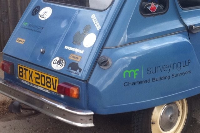

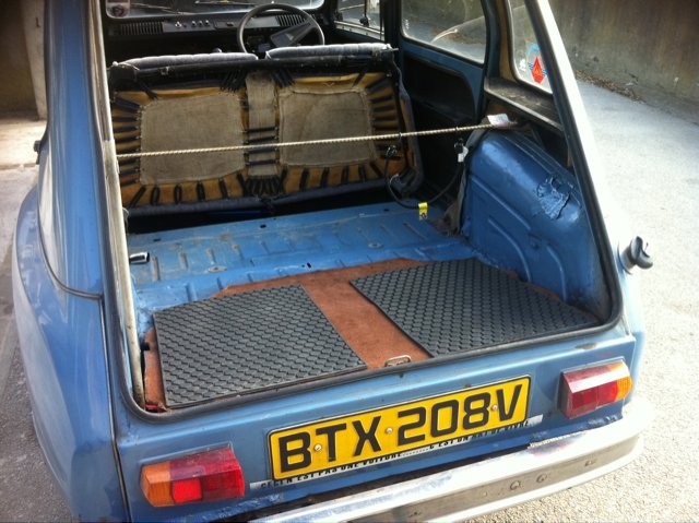

Hopefully some up to date images attached with the company logo recently applied.
231086_10150594939890414_665365413_18648528_3665737_n.jpg [ 61.27 KiB | Viewed 4505 times ]
226094_10150580340260414_665365413_18467519_5532194_n.jpg [ 89.13 KiB | Viewed 4505 times ]
225647_10150592891035414_665365413_18621988_1016064_n.jpg [ 71.38 KiB | Viewed 4505 times ]
