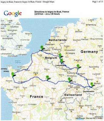

Been planning my trip to Spa and it is getting bigger all the time. Never been to Brugge so going there first and afterwards across via Lux to Germany for route 500 and down to Swiss boarder for castle (the one Disney used as model for his) and then back home. The route shown uses lots of motorways so it will alter from that but overnight stays will be the same..

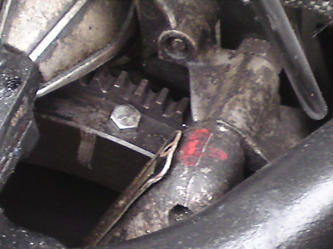

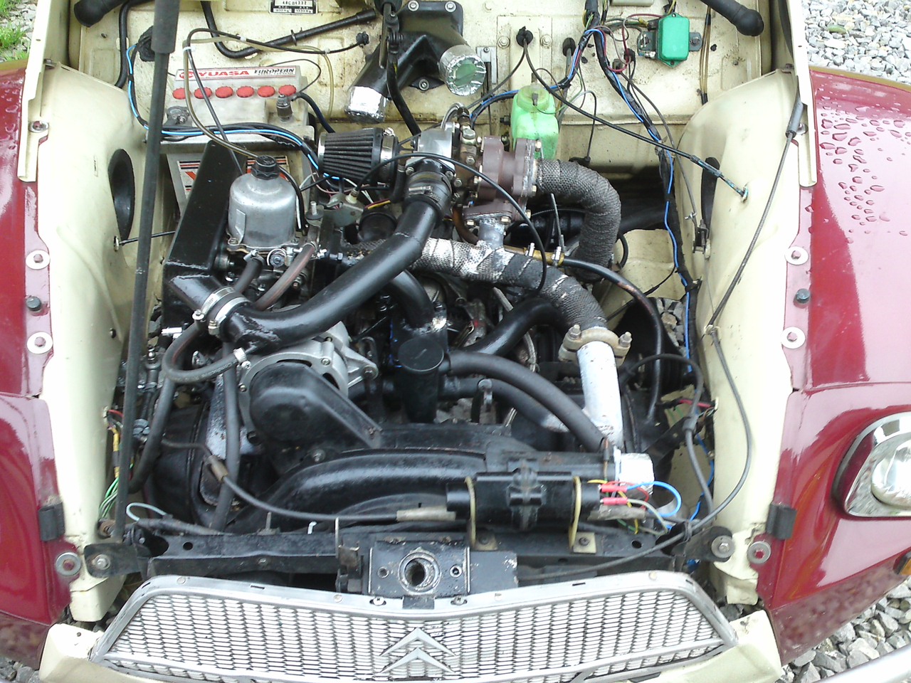

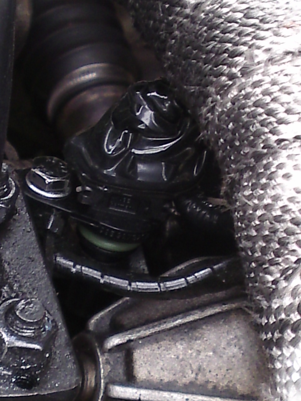

Photos of the 1 - 2 spark installed. I drilled the flywheel @45 deg before TDC and threaded 6mm (non stainless bolt). The flywheel sensor is mounted on the LH side of the starter motor (hard to take photo) (looking from the front). Just connected the wires up and hey presto car works great. I have kept the 123 ignition just incase and it takes 2 minutes to swap over (not that I think I will ever need it.

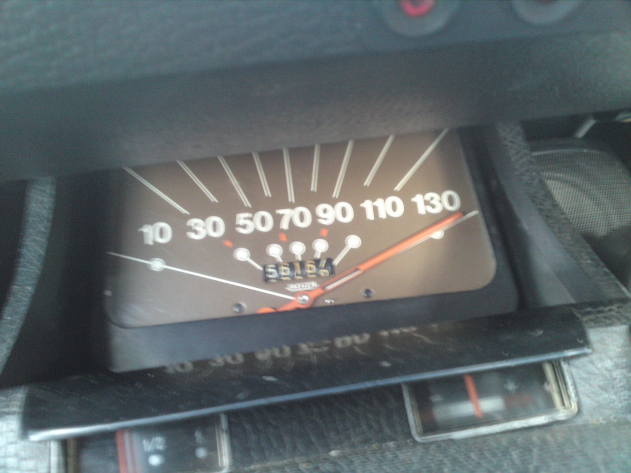

I knew car would hit rev limiter in 2nd and 3rd gear easily so today made excuss with misses to go along motorway to local town. Photo shows flat - route national N84 crusing at around 105/110 kph and floared it and hey presto it hits rev limiter of 6500 rpm in 4th.
