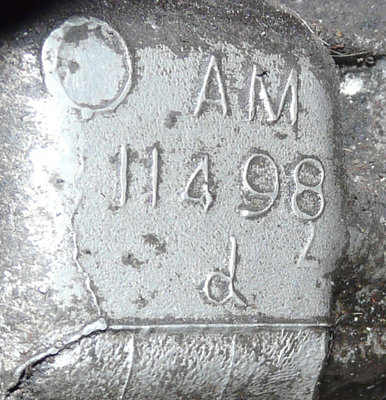

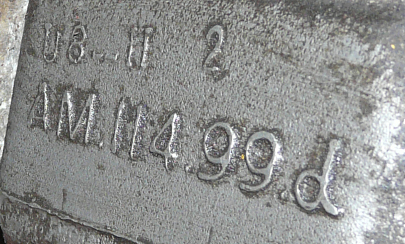

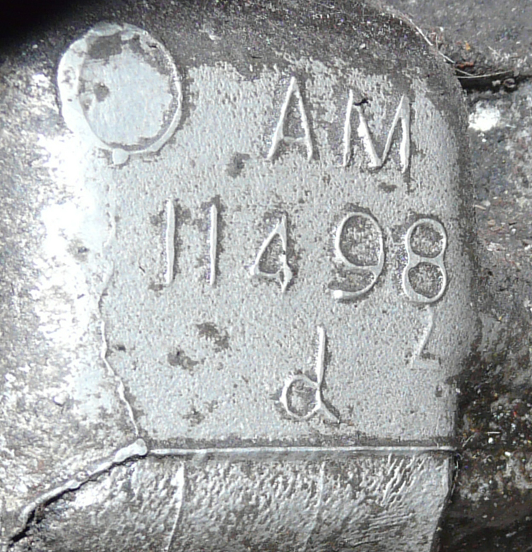

Looking at the pics again (including another one that I found, of the other half of the casing) I think that what appears to be "M4" is in fact a trick of the light:
This side says AM 114 98 d
and I'm pretty sure this says AM.114.99.d

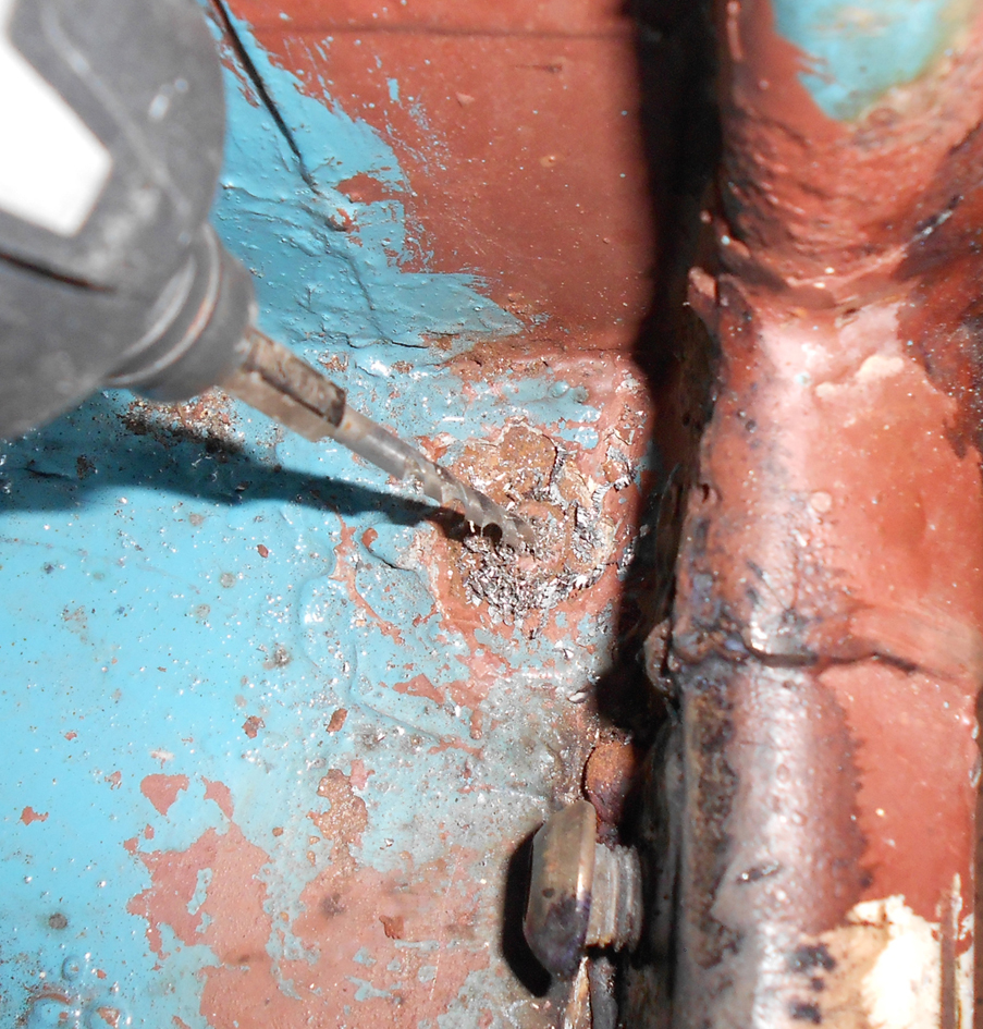

Then I decided to get the shell off the chassis, just to make sure that I could get at all the rusty bits and zap them good and proper. So, I undid all the bolts inside the van, and the ones holding the rear of the vehicle... then came the annoying bits!
One bolt was all painted in and gunked up and wouldn't come off. So I was obliged to drill it out:
which was slow and annoying enough, until the drill bit broke. No spares! Doh! So I hit it with a hammer until it broke. (That'll teach the bastard!) But the body still wouldn't budge!

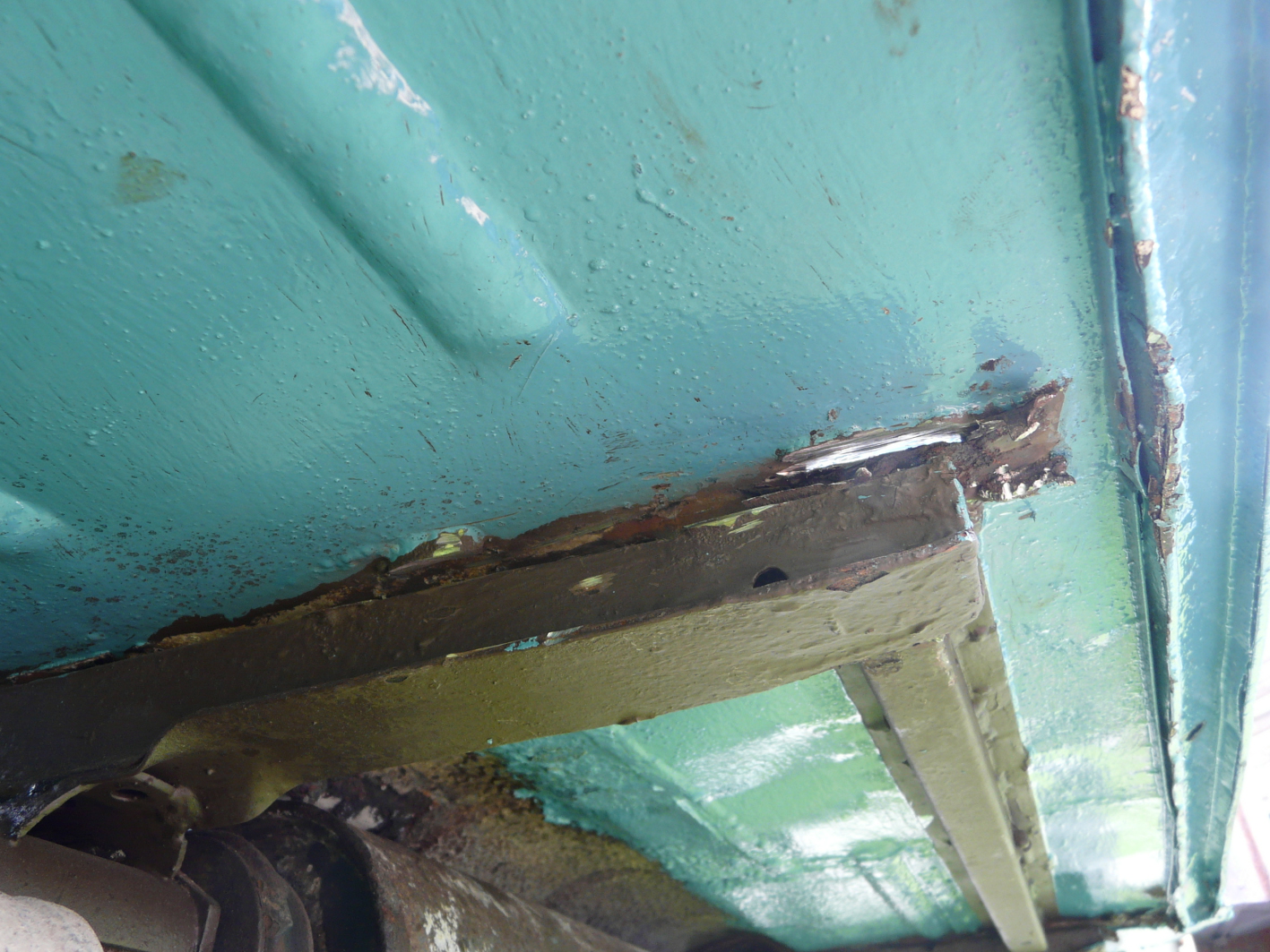

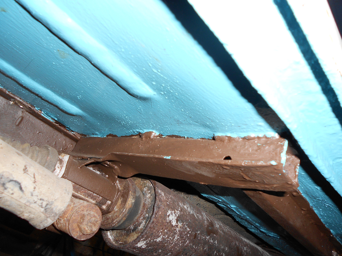

Peeved, I went back to the body-off job. Still couldn't get the body to separate from the chassis. So I had a good look underneath... and discovered a bit of bodging that an old-school French farmer would have been proud of:
Some twunt's welded the body to the chassis! And the space is too tight to get an angle grinder in!

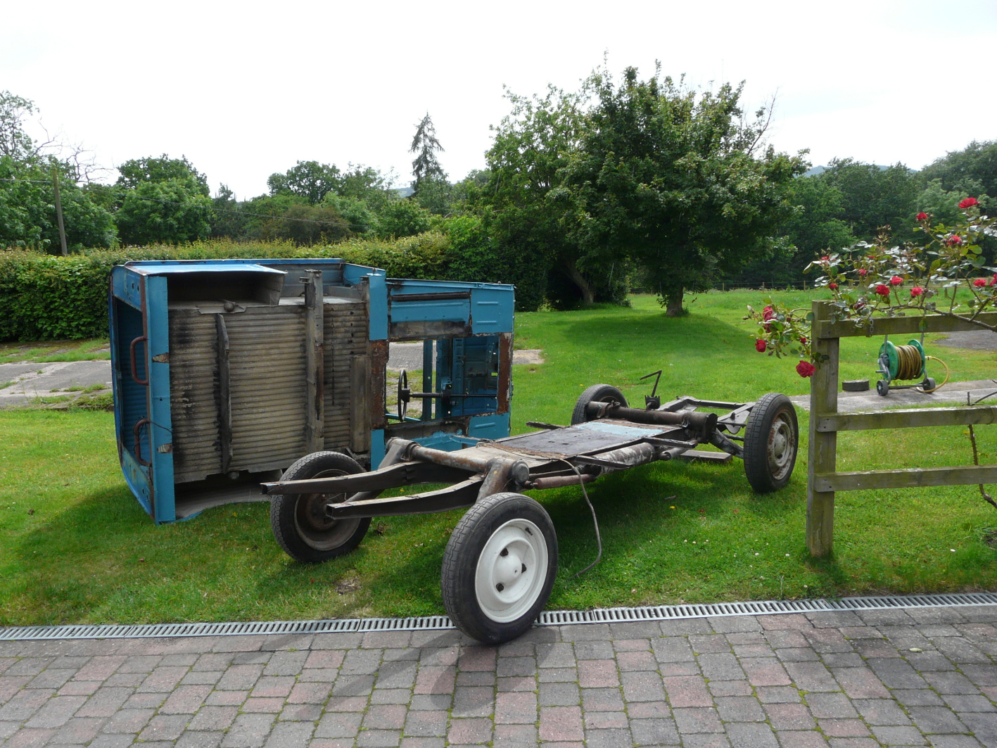

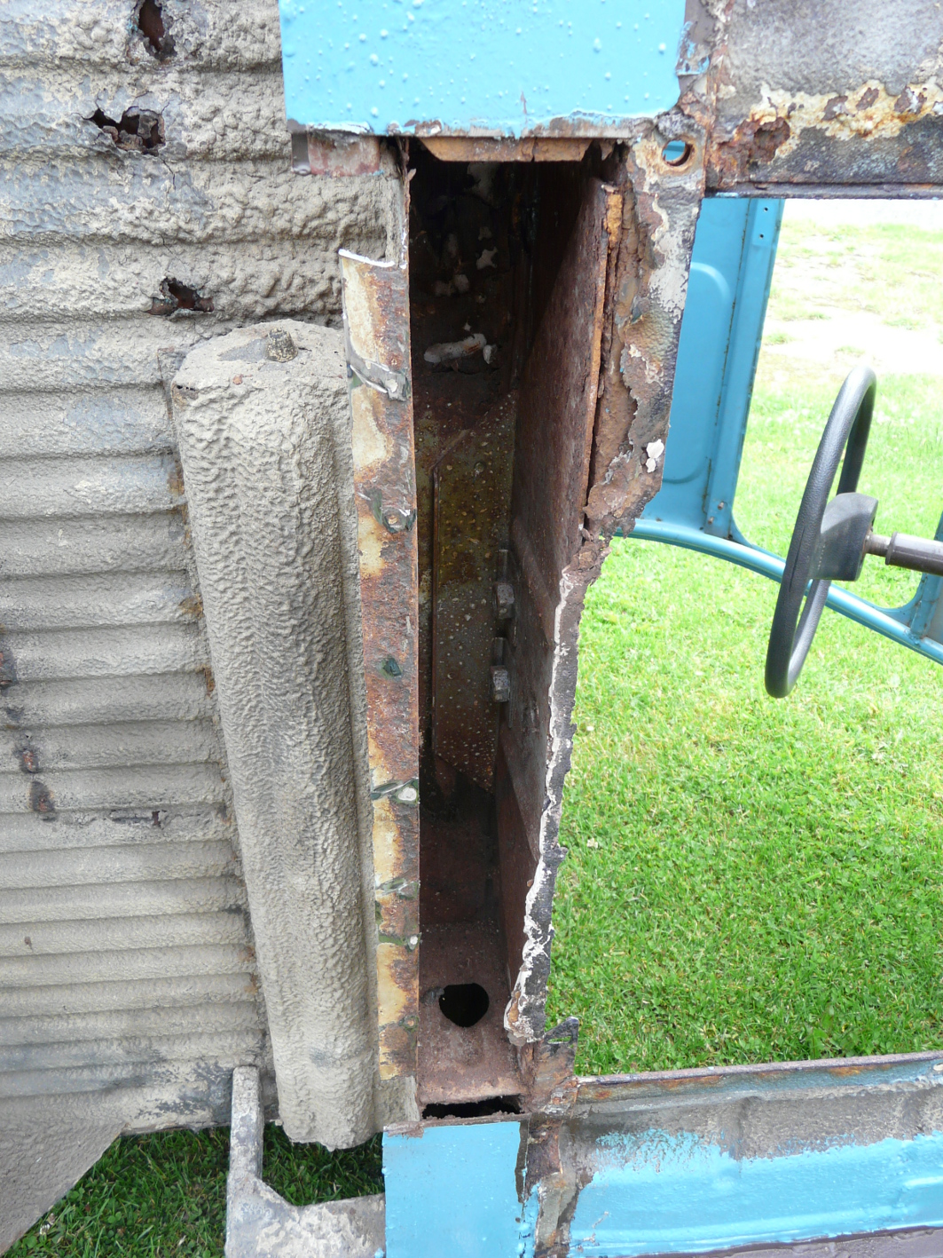

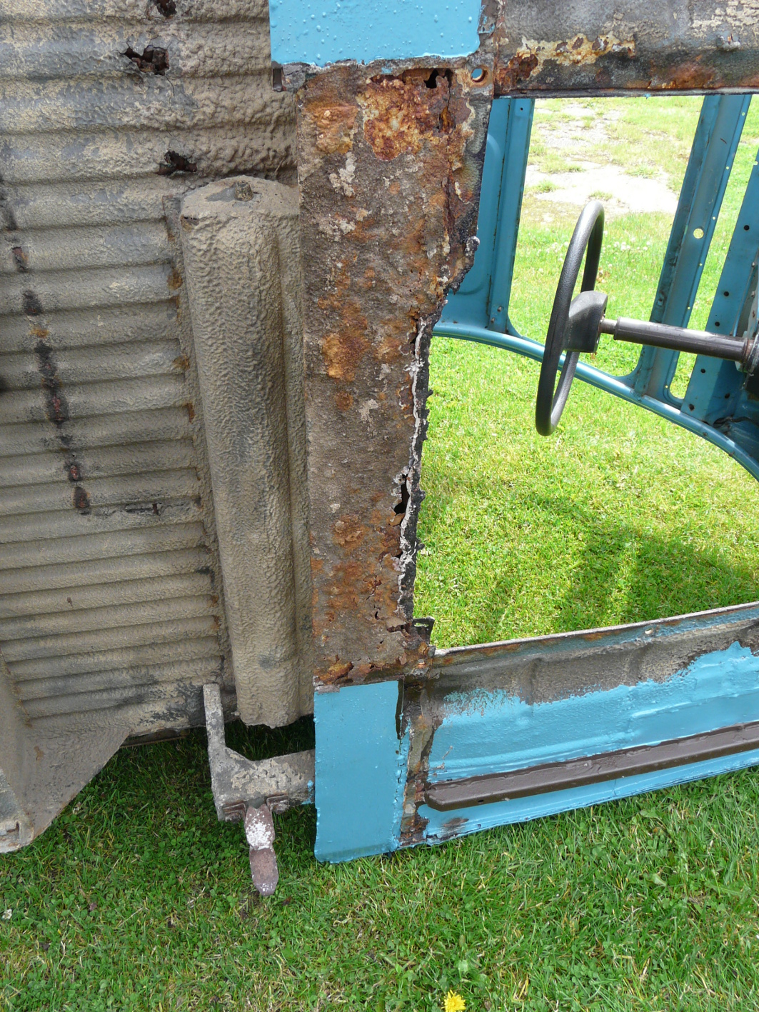

Made some progress today! Armed with some super-thin cutting disks I set to work on the bits where the chassis had been welded to the body.
and before long I'd managed to do this
which revealed this

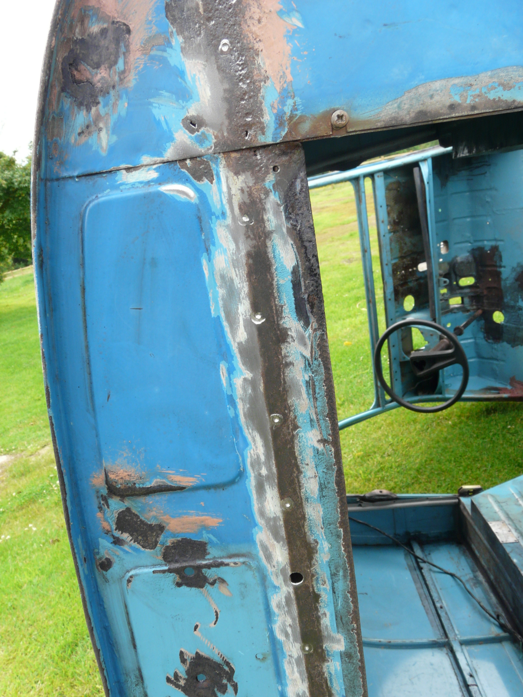

So I got the cutting disk out again and turned it into this
Then I got my spot weld removing drill bit out and detached the grotty rear door drip channel
The chassis is sound, which is nice to know!

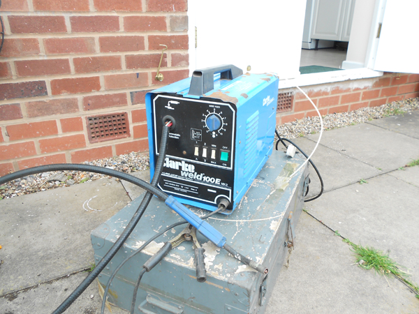

I gave it a quick clean and it works fine! Yay! Maybe I won't have to buy a mig welder after all.
Quick questions: what gauge of wire should I use for welding the sheet on a 2CV? What other settings yield the best results?

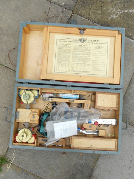

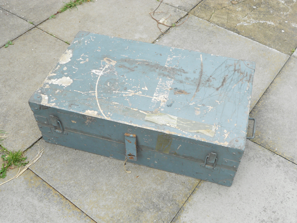

which I reckon is ex-MOD. Upon opening, the box revealed this
There's a cutting gun, and and welding gun, unused pipes, regulators, unused flashback arrestors, all sorts of nozzles, keys, adaptors, and this

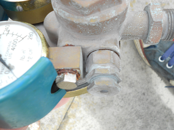

Question, and this is an important question which I ask to all welding gurus out there: should I treat this kit with extreme caution? It all looks fine, apart from a touch of corrosion on the pressure gauges as shown here

You could put some soap and water mix on the pressure gauges and other fittings to see if it leaks gas, but I suppose it is oke .
I presume it is only a small bottle that fits the gas supply.
June 24th, 2012, 5:44 pm
Post Re: 1976 AZU250
0.6mm wire, if there's part of a reel with the welder, check that it's not rusty as using that can clog the liner through which the wire is fed.
Probably the lowest setting or next one up for 2CV bodywork, the only 'fine tuning' you should need to carry out is setting the wire speed.
The 100E is still produced, I think...
A copy of the manual can be downloaded here;
http://www.clarkeservice.co.uk/product_ ... ders.shtml
When I used a Clarke welder, it was cheaper to order spares from the service centre ( in Nottingham?) than buying them from Machine Mart.
Also well worth looking at the welding tutorial on Malcolm's Mig welding forum.
http://www.mig-welding.co.uk/
Have fun. ;)
