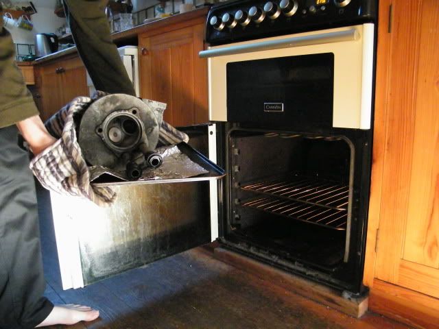

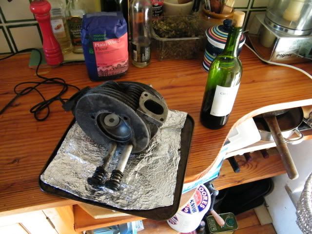

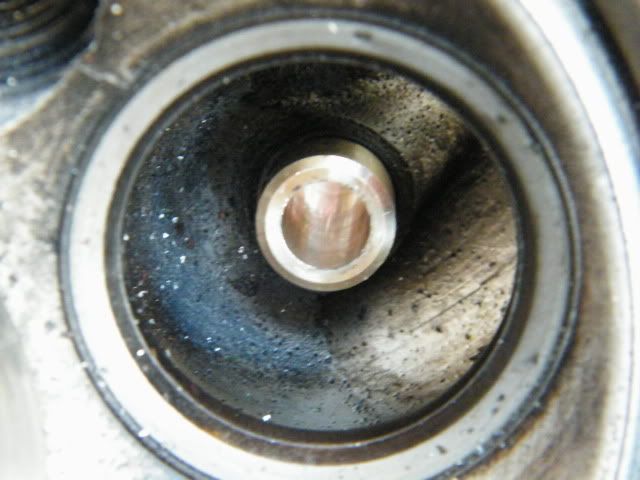

No bodywork at the moment, but hopefully the engine should live again soon
New valve guide installed that is neither cracked, or protrudes so far the valve won't actually close!
Thanks to Mr. Ecas for that advice :)
