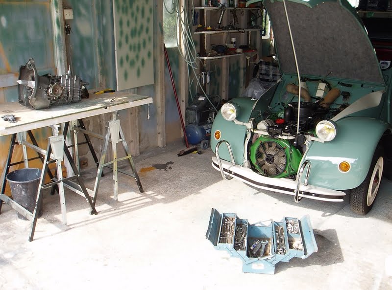

In order to tackle the gearbox work that is now necessary I have made a space at the rear of the garage so that when the car is pushed right back I then have the room to work up front. To prevent any damage occurring to the rear caused by scraping the car against the garage wall I wrapped up the bumper with a little foam left over from trimming the seats as shown above somewhere.
The car was then pushed right back against the wall, and a temporary bench set up at the front which now holds the replacement gearbox. I'm hoping that I may get away with just a little gearbox 'corrective surgery' rather than a full transplant, but if the worst comes to the worst then at least I'm prepared.
So this afternoon off came the front wing to allow for easier access, and again this gives a little more room in which to work. With the negative earth terminal on the battery disconnected, I set to removing the bits that are in the way, these are the heater tubes, gear lever control, and the air filter support brace.
The gearbox lid is now get-at-able, so I carefully undid the set of 11mm nuts that hold it down. As two of those also hold down the front brake pipes it's a bit tricky as you can't really bend them buggers out of the way once loose without running the risk of fracturing them. This has taken me to the point where I can now carefully lift the lid, and hope that I'm able to catch the detent spring before it leaps into the bowels of the gearbox. I suppose that if I removed even more stuff access would be that much easier but I'll see how it goes for now.
When I have more time I will lift the lid, and attempt to screw the collar back on to the shaft and peen it on (hopefully) permanently, if it works then the car will be fixed and I'll be all smiles, if it doesn't - possibly less so. :|

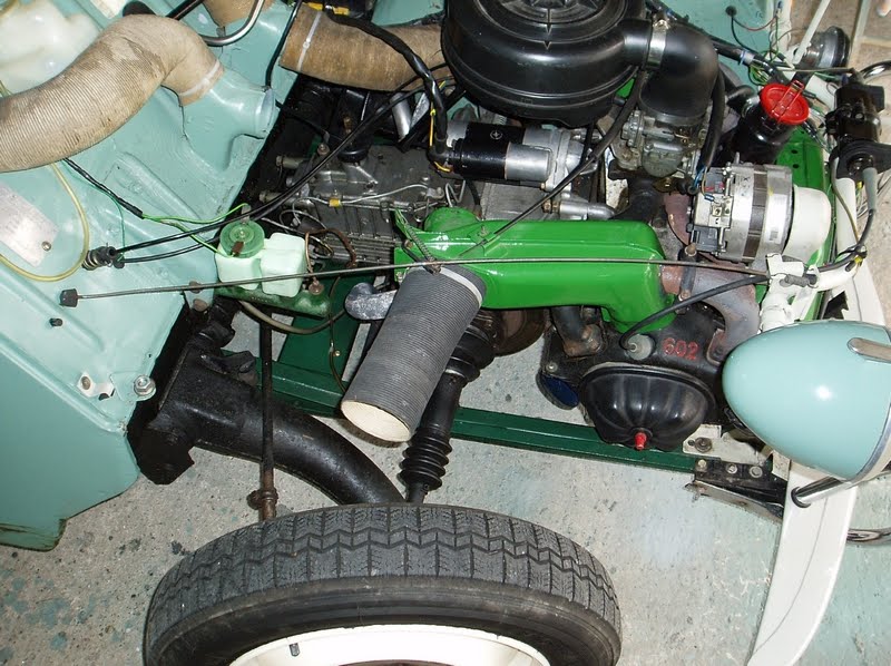

I also noticed when I took the wing off that the insides of both front wheels are thickly spattered with grease. The stuff seems to be escaping past the rubber boots at the bottom of the drive-shafts. I used cable ties on them rather than the metal banding stuff so I'm wondering if that's why?

There's not meant to be a clip at the outer end of the sliding joint bellows. With the large suspension movement of the 2CV the bellows would be torn (as was one of mine). If grease is escaping past then I suspect there is too much in the joint. Hard to judge I know. Maybe someone more experienced than me will have a tip on this one.
Or maybe you mean the 2cv joint boot. That would explain the grease on the wheel backs. You have to get the cable ties on that very tight and, of course, there are 2 on it.

Yes I do mean the 2cv joint bellows, but I'm glad that you mentioned that there shouldn't be one on the drive-shaft lower as I put a cable tie on there too. (which I'll now remove.)
I thought the 2cv joint ties were done up very tight but obviously as they are leaking there is still room for improvement. I'll cut them free and try again. Thanks for your input knightly. ;)
