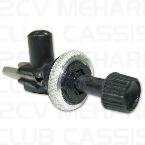

I had the rear fog light switch blocked in the on position...annoying. Even with force i couldn't push it back in. So i tried to spray a bit of silicon oil in the switch along the buttons shaft. Happy that it started working immediatly. So i don't have to take the dash apart... pfff.

Yes it wasn't a electric problem but the button was just stuck in place.
It was one of this old type switches.

It's from a normal 2cv6 special. It is an old type switch that they used also in the 60's. Even my wiper switch is the same as was used in several citroen models from the 60s.
