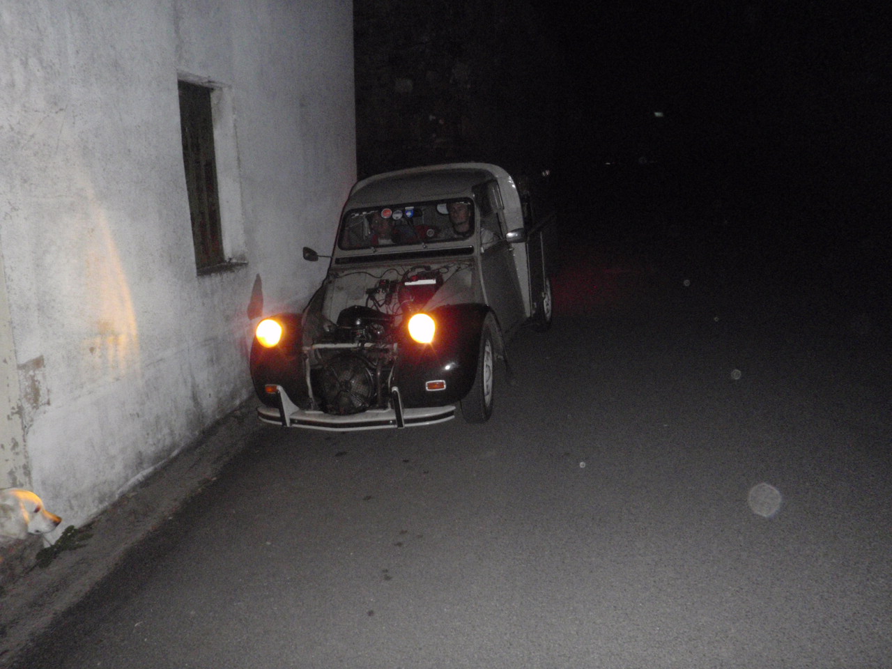

Thanks for the roses Sammie boy. One final pic from our test drive
Hope your repaired gear box will serve you well and for a long time. Look after it (it is not a reconditioned box) good to see that you understand the need to slow down and to drop the gear oil at the same time as the engine oil.
We welcome you any time in lovely Bretagne with or without gear box jobs :mrgreen:
