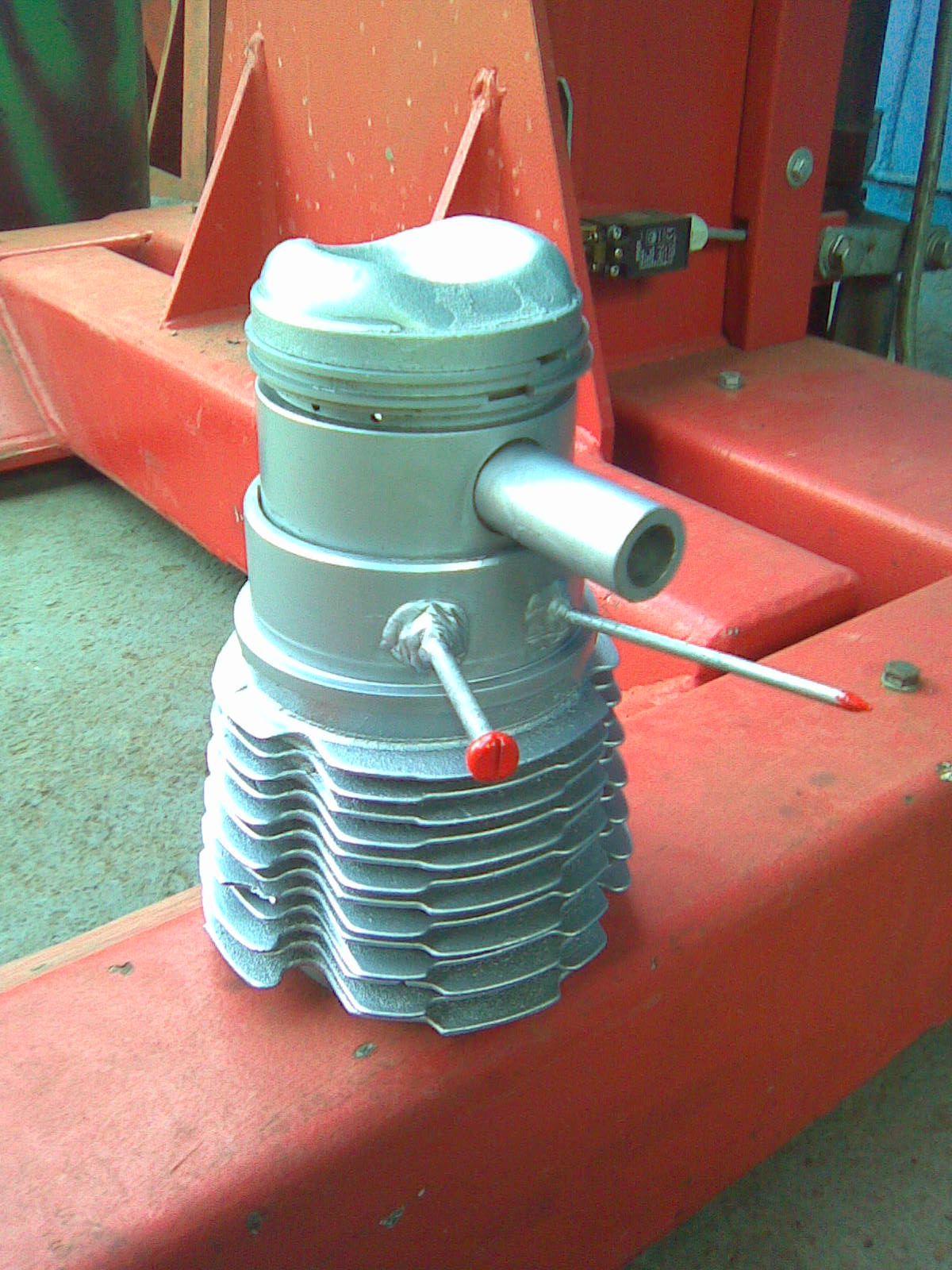

So, does it spin over on the starter or, better yet, the starting handle?
March 21st, 2010, 3:16 pm
Post Re: Project Raid Europe - 2CV6 Spécial
Started to spin on the starter motor, But then kind of died in the same way it would a flat battery.
What bodge did you do to the filter?
and more to the point about it spinning
does it have compression?

Max,
if the dipstick is being pushed out, usually there's only one reason, unfortunately.
There's been a partial seizure of the engine, so either the rings are stuck in their grooves or are broken... :cry:
Not only will compression be very low, but the huge amount of blowby pressurises the crankcase, so pop goes the dipstick.
New pistons and barrels needed, as well as setting the timing up so there's no trace of pinking?

Gonna go with your thoughts Ken. My Dad said the same about the partial seizure. Harrys up this weekend so were going to giver her new pistons and barrels. He's going to bring a spare engine just incase. (we might just put in that to be honest) :)

Ah max i found out where the barrels and pistons went :roll: i'll see what dads got in the week but i don't fancy changing 2nd hand barrels n pistons with out fitting new rings....
the spare engine i have is good so think we'll go with that ;)
