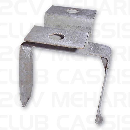

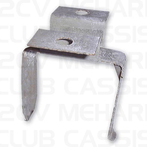

On the exhaust hanger you used to be able to get hold of these for the hanger at the back of the torpedo silencer, which were supposed to reduce lateral wobbleness and prevent breaking swan's necks.
(don't know why in this picture it is shown at the front of the torpedo though ??)
Couldn't see this after a brief search on Ecas' site but maybe I just haven't found it yet, you could give them a call though?
Saying all this but I've always had a short tailpipe on my 2cv and never noticed a faster than expected turnaround on Swan necks...
Chris.

These were a factory fitting on vans and Meharis, afaik... ;)
< http://www.flickr.com/photos/30132857@N06/3613104301/ >
When fitted, they would still allow some vertical movement of the exhaust in its rubber hangers, but restrict lateral movement.
If a tie wrap is fitted _lightly_ around the rearmost rubber hanger, it seems to fulfil much the same purpose.
However, the problem is that as the message has got passed on, it's become scrambled, so that you will find tie wraps on the front hanger only, on both hangers or tied up so tightly on the rear hanger that little or no movement is possible... :(
( Go on then, tell us where that picture's from, with the fitting at the wrong end... :roll: )
....or tied up so tightly on the rear hanger that little or no movement is possible... :(
Err... :oops: :lol:
I tied mine tightly because there doesn't seem to be that much lateral movement in the rear hanger to begin with, so I thought; "Well if that small amount is supposed to be bad, then less must be better."
Does anyone know of any failures or is it becoming an urban myth type thing where everyone has 'heard' it happens?
..Copied the picture from Cassis' web site :)
I have had some times in the past where the flange has broken around the end of the swan neck, but as I always generally used to run exhasusts until they are 80% coke tins before then it didn't seem to matter.
