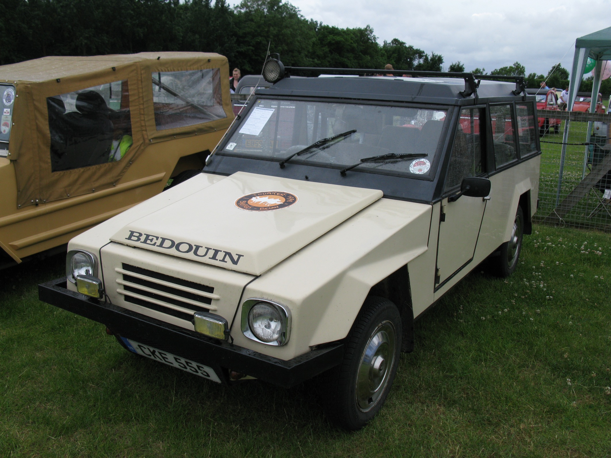

she's looking good Bertie. Just found this pic from reg day 08. She looked pretty smart. I like the roof in black I must say.
December 1st, 2009, 3:04 am
Post Re: Belinda: on the road
That isn't Berties Bed' mate, That's Eleanor Chubbs.
December 1st, 2009, 9:19 am
Posts: 682
It is indeed. I have many other pics of that fine car, provided by Neil just after I'd got Belinda so that I knew what she SHOULD look like.
