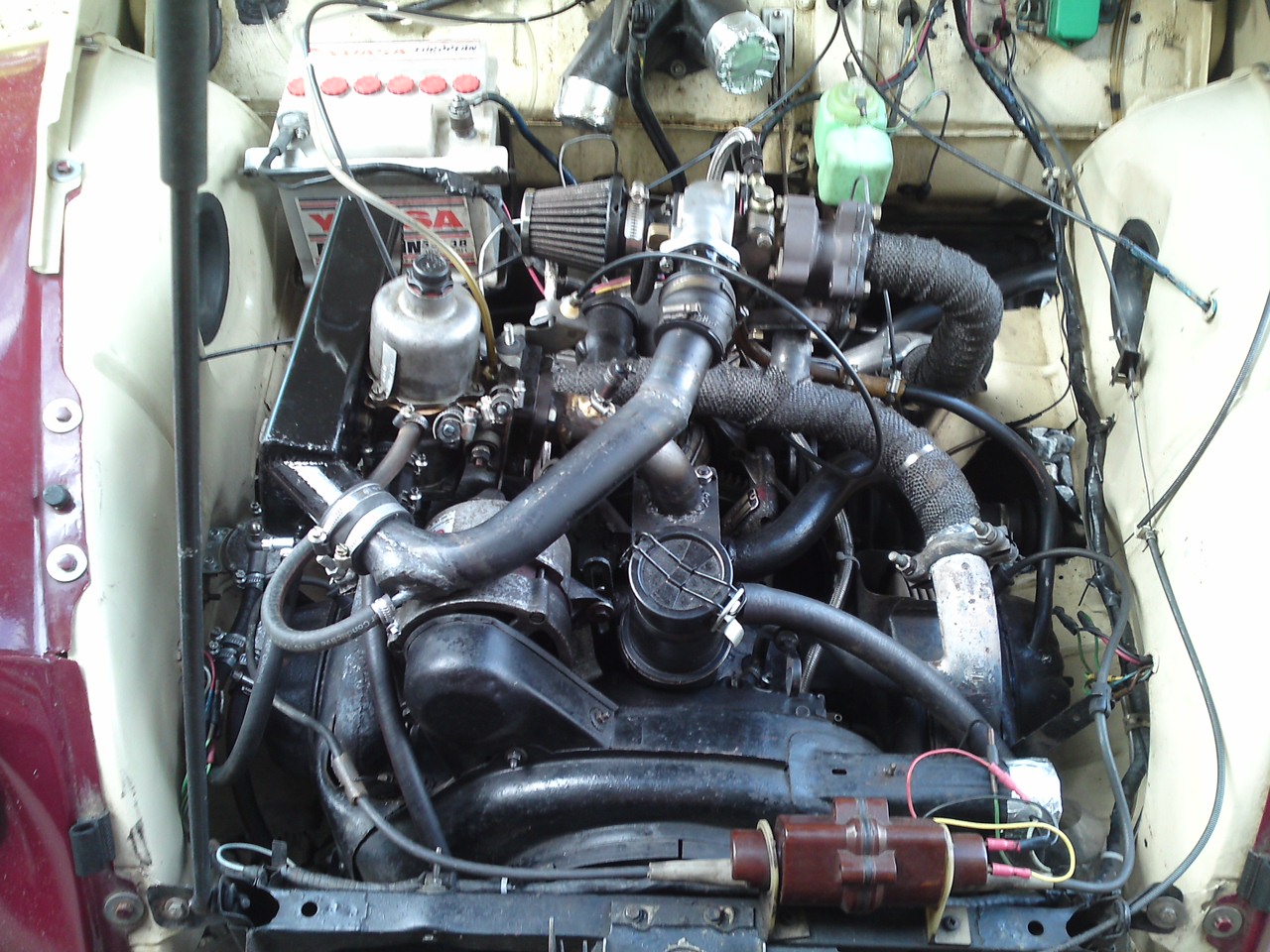

Hi Joolz - contacted Burton about there setup but no answer. Please find picture of mine. Went for nice drive today - good to have some more pull up the hills.
To explain picture - IHI 31 turbo, HIF 38 carb (sealed). Pressure regulator down by the plenum chamber. Pitot tube in bend of pipe from turbo to plenum - this goes to the vent on the carb to pressurize the petrol - more boost - more pressure so no lean out at top end. Exhaust goes from turbo to original cross box (1 port only, other blocked off) and then to pipe out of side of car. Not noisy but nice burble on over run. Tried with no exhaust and same power so no restricition on setup.I have standard MINI 1000 needle and the plugs are nice colour - will invest in Lambda sensor when I have some more money.

Awesome stuff indeed.
Took me quite a while to trace all the plumbing, mind you... :lol:
A few bits seem to be lost in translation as well, but I guess pilot = pitot & lambar = lambda ;)

Hi Ken
Never been able to spell :oops: Pitot tube is correct -
