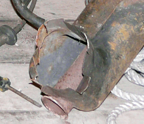

Someone has butchered the 435 heat exchangers to 'fit' onto the 602 engine, probably the same story with the 435 crossbox. :(
Ken
May 2nd, 2012, 11:45 am
Post Re: 1976 AK250
Hmm. Ah well. Shame it's not the 435 I thought it was, but this van has obviously led a pretty full life - I'm not surprised that the engine isn't as it was when it left the factory.
I've been asked to bag some photos of the engine to show how heat exchangers were modded etc. I'll take some at the weekend and post them up. In the meantime, here's the only shot I have so far that gives a clue... and from the look of things all you need is a pair of tin snips!
